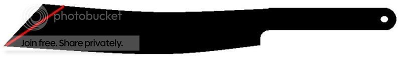

I'll play around with the paint program later when I get time and toss out a proposed design for it.
Thanks for replying too Nebulae.
Edit: Or I can just find one close to what I was thinking. Its the top one. Though im planning on straighter lines on the tip. Maybe I might round off the edge so the tip dosent break as easy. Id like a lanyard hole in it and a bit more drop of the blade in front of the grip too. As for handle material, paracord should work unless I can find something better.
The red line is just another angle im considering. Weaker yes, but it'll help cut weight.
