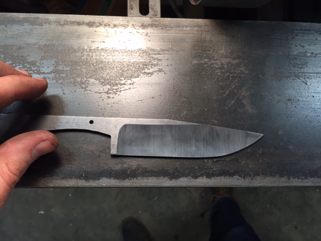

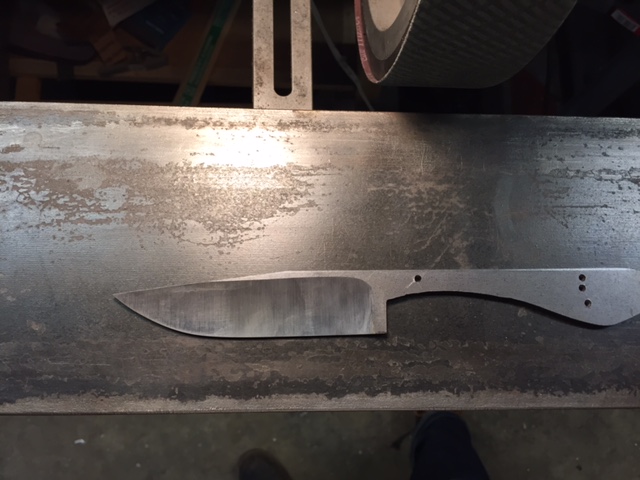

I'm having a lot of trouble getting my bevels even on both sides and I don't know what I'm doing wrong. I have a 2"x72" variable speed angle pro grinder and a tool rest for both my wheel and flat platen. I started free hand and After about 15 ruined knives decided to start with a jig. I have the DD Grinding Jig and just haven't had any good results with my set up. I have tried to make sure my rest is level with my wheel and platen but every time I grind a knife my bevels are off. Everything looks level and even to my but obviously I'm doing something wrong.
You can see in this picture the one bevel goes out further and comes up higher, the other side is thicker and doesn't go out as far on the blade. I have made equal passes on each side so I don't think that's the problem.
Any help would be greatly appreciated. I feel like I'm missing something very simple but I'm out of ideas.:mad:

If your steel isn't straight & flat this will happen.I use a carbide grinding guide along with the bubble jig and can compensate for this problem (cheat the bubble).Plus my plunges stay pretty even.I sometimes use the guide like a sled jig that rides over a couple pieces of scap kydex glued to work rest.Your grinds look hollow and look pretty good to me(I can't do it to save my life) Good luck. Lu

a - your steel isn't flat
b - grinds uneven - try to scribe a center line on the blade edge and a line on each shoulder... grind to each. This takes practice but the lines will give you a good reference point.
The problem I think you have is push force control, you are probably right handed and you push a little harder on the bottom pic with your right hand than the top pic.

I believe he is referring to your blade steel. You should flatten it on the flat platen before grinding bevels to make sure both sides are flat. If both sides are different, they will grind different. Use new, sharp belts and take your time. Hollow grinding takes time to learn. You will get it.

Most steel is just rolled out and can have an uneven thickness or warp. You can straighten a warp and grind to even thickness.
Precision ground steel costs more but will be a pretty even thickness. Steel that isn't hardened can warp easily, for example just by knocking the end of your shipping tube.

To me it looks like your grinds are very close, and that you are possibly thinking that the jig is supposed to do all the work for you. Its all about where pressure is applied. A push stick is a good idea even (or especially) with a jig, because the steel can flex when putting pressure on the jig as opposed to the blade itself. Try using your jig with a push stick in the middle of the platen, or wheel, and just slide the jig with one arm, while applying pressure with the push stick with the other arm. And it does take some time getting used to how to "come off" of the belt in the tip area.. usually you need to slightly pull back on the end of the tang area on the knife a little bit while sliding along the belly to tip area on the belt in order to get the bevel to match your blade profile.

I'm a rookie too, but it looks to me like you just went too deep on one side. With a wheel it's not going to climb up as quickly as a platen, so easier to go too deep. Are you scribing two center lines on the blade edge?

The bevel will climb where you apply pressure. Try understanding the geometry of what you are doing. Pick a piece of wood and exaggerate the movements to see what happens and tune your process accordingly.
