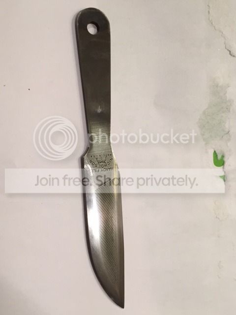

I am a newbie to knifemakilg. I am just finishing my first blade from a Nicholson file an currently have a Harbor Freight 1x30 grinder, which after a day of grinding, I can see it is not gonna do what I want. I have about $1000.00-$1200.00 budget and am thinking I want a 2x72" grinder. Can you guys offer some suggestions and is a 2x72 a good idea? Many thanks in advance! Jim
