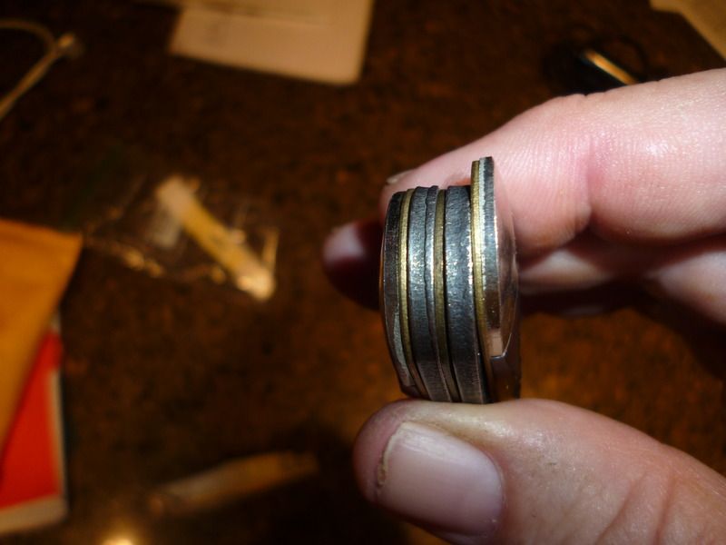

Your blades look funny. Did you replace them? If so you may have left them as-stamped and so they are too thick to allow the pin to protrude far enough into the keyhole. Eric should be along shortly and tell you positively the problem and solution.

What I am saying is that if the tangs are left as-stamped they may be thicker than the tangs of the original blades, either in material thickness overall or because of an edge flash left from the die. Check both with a caliper.
ETA I reread and I think you are saying the pivot end is fine, but the other end won't close up. Are those springs original? They don't look like they have been glazed flush before. Again the thickness problem with possible flash.

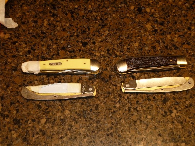

This is Old "New" Stock:
@ Blade's, Spring's, Brass Liner/Divider's
@ Bolster's
I am building "4" New Knives, from Schrade Parts.
Back to the "Anomaly":
Looks like all I need to do is tap it down, but want to ask first before taking a (Press/brass hammer/wooden hammer/ vise), to it.

Steven, as long as the center scale (liner) and the bolster scales (liners) are the same length (and the holes line up), you should have no problem. It is a tight fit in the slot area on the butt end of those knives, you don't want any gaps between springs. Might need to tap it down with a plastic headed mallet or something similar. If you have to do more than tap it, something's not lining up correctly. Don't forget that the center pin goes in last on these knives.

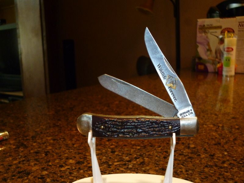

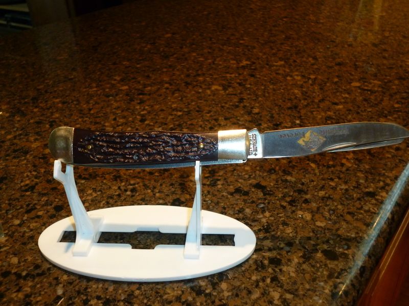

I have been having fun with a few OT's recently, putting some new covers on them. Looks like you are having fun too, please share pics of the finished work when it's done.

I will do that, on posting to Pictures.

I will do that, on posting Pictures:
Sorry the first three are out of focus

Were those knives built before, or are these pieces you are putting together, like a kit? The bolster edges and springs look unfinished.
Yes - Pieces I am putting together, from parts I procured on eBay.
I have 4 - 4 1/8 knives and 1 - 3 7/8 knife to put together, needing the center pivot pin put in.
I would just be concerned that the parts might not fit together like they would in a knife already built. Don't get frustrated if it doesn't go smoothly.
