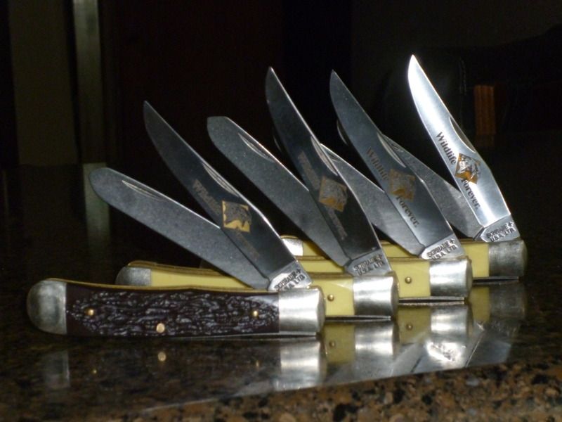

[/URL][/IMG]
Eric Really Did IT!!
[/URL][/IMG]
I cannot take credit for these four beauties, they are AWESOME!!
Thank You Eric!!
I hope if you where able to have documented it in video, I would love to see it.
Steven K.
