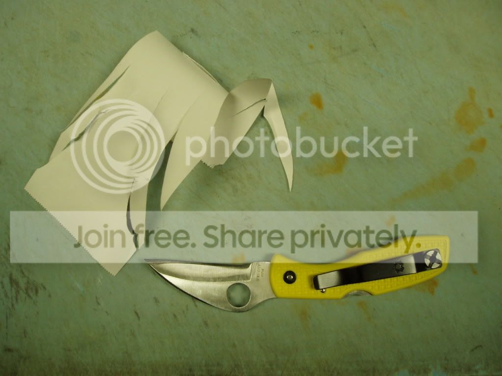

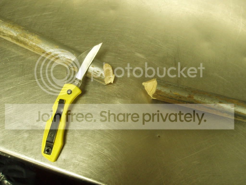

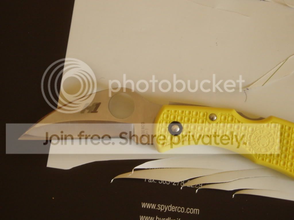

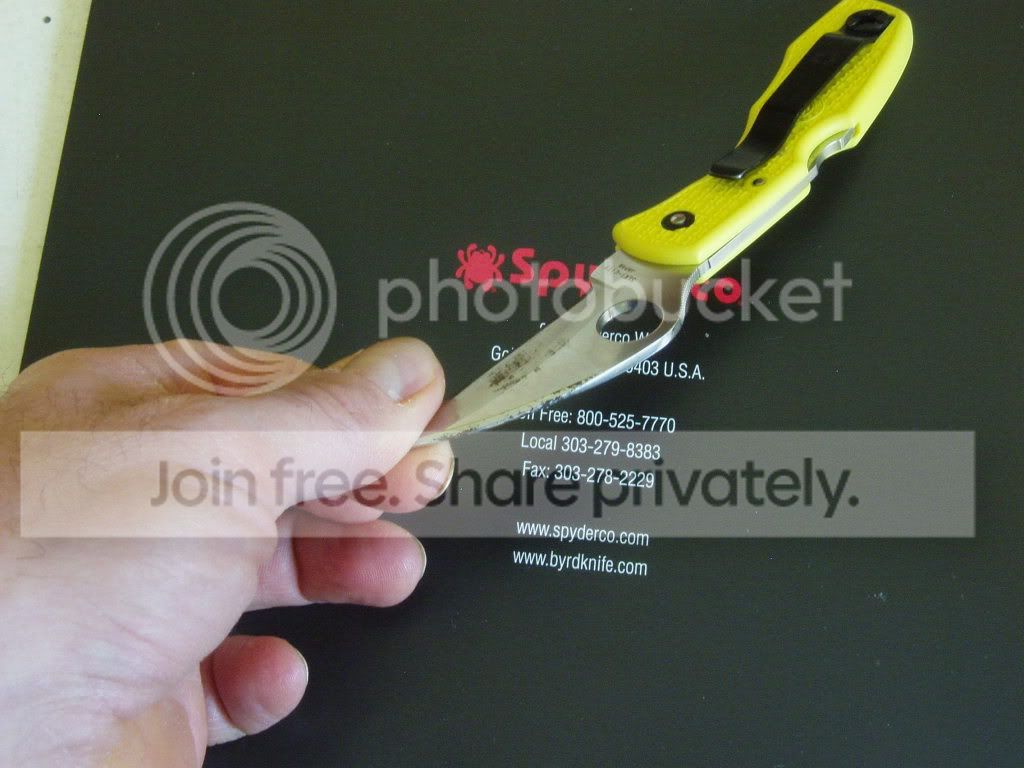

Today was a good day to baton the crap out of this knife - "for science".
My hands took most of the shock, let me tell you. There's some wood, dirt, or whatever on the blade, but it still slices paper great after beating it straight into the wood time after time.
I steeled and stropped on the leather and it's back to shaving. H1 is awesome! There is, however a small problem with the action. Where you see the blade opened to in the last pic - if you thumb it slowly, it pauses at this point - kind of like something chipped away minutely on either the lockbar or the blades lock area - and then closes and locks up very securely. If I could take it apart, I'd know for sure. I won't take it apart until I render it useless. I want to know what FRN will do it extreme cold - that's my next test. :D
If I destroy it, I was thinking of making some pendants with the H1 blade steel - plus I'd have a spare clip.
Thanks for looking at my highly professional scientific testing. ;)
- best wishes, Jazz.

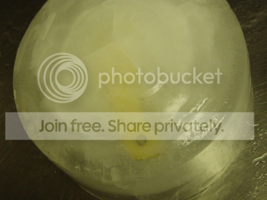

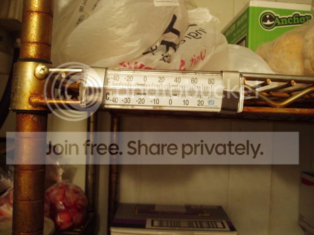

Well, I took it to work and put it in the walk-in freezer up by the thermometer where I know it's - 20 C...

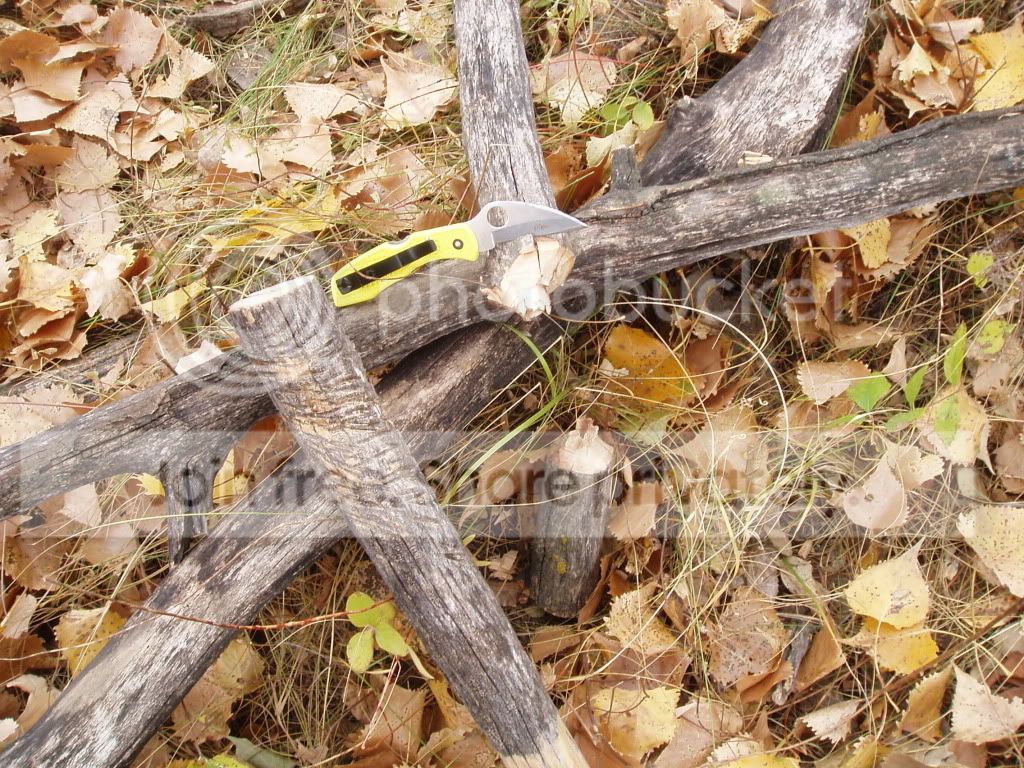

After about an hour, I went in with an old broom and a chunk of another broom's handle and went to town on my knife - I was not nice (I felt bad for it, but it's for science). I batoned through the broom's handle - it's hard - Maple, I think. I took this pic later to show you the size.
I pounded on the knife's sides, from top to bottom, on the blade, on the handle... then I left it to cool again. I tried not to warm it with my hands as I went to town. Next I grabbed the blade and torqued sideways both ways - hard, and used my Leatherman Wave to pinch and bend however I could. - 20 C, all that, and the FRN didn't even hint at cracking - just flexed like normal and went back to shape. There's some side to side play in it now, but that could be fixed by peening the pin. Still slices paper nicely...
I can now defeat the lock with my own hands - only because I was unneccesarily cruel to the knife, even batoning it on the lockbar - really hard over and over (it takes a lot of force, but still). It feels really gritty too. I won't know why for sure until I take it apart sometime. I still want to get it out in - 40C, so I have to wait.
So far, FRN and H1 are impressing the heck out of me. I'm just a bit concerned about the lock - I can't see why it would fail (lets not be starting a big deal about this, either - I know it wasn't really normal knife use).

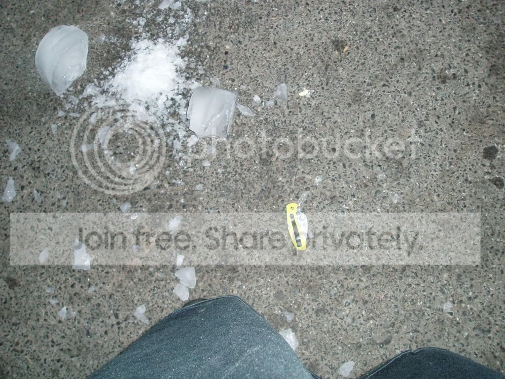

Well... -27 degrees C/-16 degrees F today... I put the knife outside for an hour to chill out.
I then flexed hardcore with all my hand strength side to side and the FRN and blade were fine. I grabbed 2 pieces of Oak and went to town again. First I batoned on the blade real hard like normal into the other chunk of wood. Then I layed it down and whacked the sides of the handle. Next, I rested the blade edge on the wood and put my weight on it... this is when I noticed the crack that must have happened when smacking the handle sides. Here's the crack...
I guess -27 C is somewhere around the limit for this stuff (with batoning and such). I'll be carrying my Milli or large Wegner in these temps from now on, but FRN seems fine (to me) down to -20 C/-5 F. I don't plan on using my knives for these extreme things, but what if?... Here's what it looks like in pieces...
