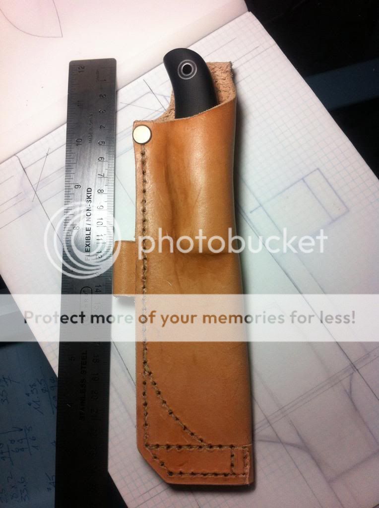

Here's a piece I did for my bushfinger (currently my favorite blade)
I can't ever find a comfortable spot on my belt for a vertical hang sheath. It just invariably is always in my way. I started doing crossdraw pieces a couple years ago and loved it. You can hang it strong side, weak side, every reverse on the small of your back. Because it was a filddleback (and gorgeous) I added a leather wrap that goes through en eyelet so when I'm mid hike, I can actually tie up the fiddleback in the sheath. Once I set up camp I don't keep it tied...it's fits in and locks up real well but with it being horizontal, I just didn't want to take any chances.
My only dislike on this sheath is that I still don't have a belt sander to get my edges really crisp. You can see one or two bumps along the burnishing line that a vertical belt sander would make clean. I use a little dremel. Works well but not as precise.

solid4ever-I don't use a belt sander on edges. Only thing I have is a 6" vertical disc sander. Works well. A Dremel drum helps a bunch when you have tight curves, just don't let it dig in.
That's for the tip, Rick. Yeah I'm thinking about buying a dremel "stand" so that I can at least keep either the dremel or the leather stationary. having both free lends itself to small catches.

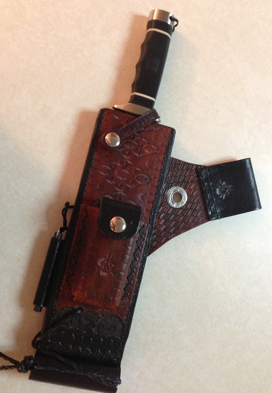

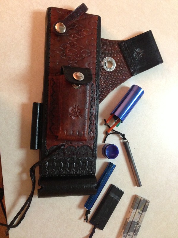

This was one of my wackier ideas...
I don't really like vertical carry sheaths. I became a big fan of crossdraws and from that, got this crazy idea of carrying a larger knife in the style of a low slung saber.
I created this "Survival Scabbard" for a SOG Creed. It hangs really really well (but I quickly realized it's not really practical for camp). There's a cylinder case at the base for matches, tinder, water tabs, etc.. The sheath pouch fits a whistle, a flashlight, and a sharpening stone perfectly...there's a small firesteel loop on it as well. It's meant to be carried on your left side for a right handed cross draw (like a dress saber)
I'm still not utterly convinced it's a waste though... perhaps making it hang a bit higher on the hip and making the space a bit more efficient, I'd kinda like to try this again with a Fiddleback Camp knife. Instead of a pouch on the front, a piggybacked sheath for a bushboot or a runt.

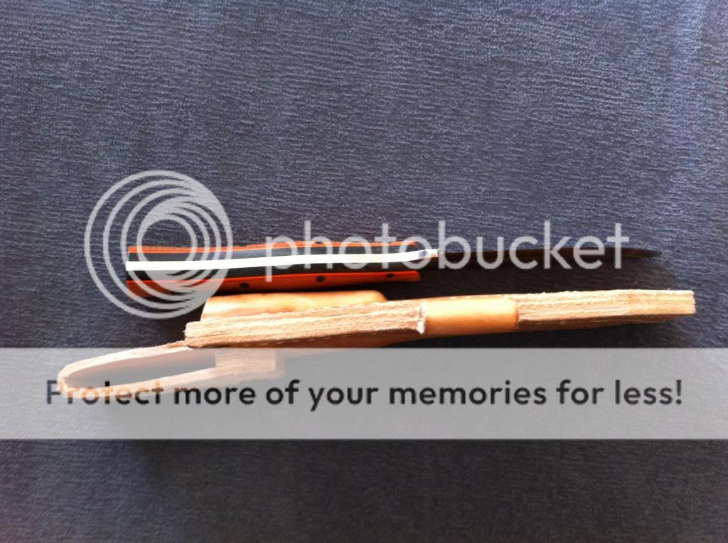

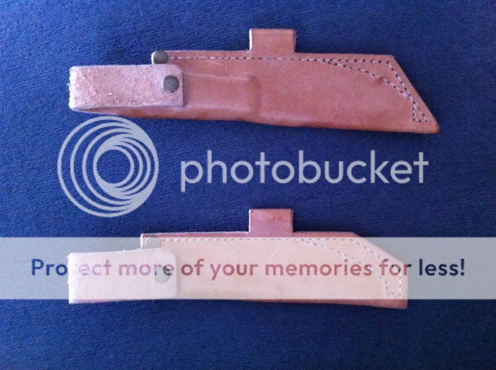

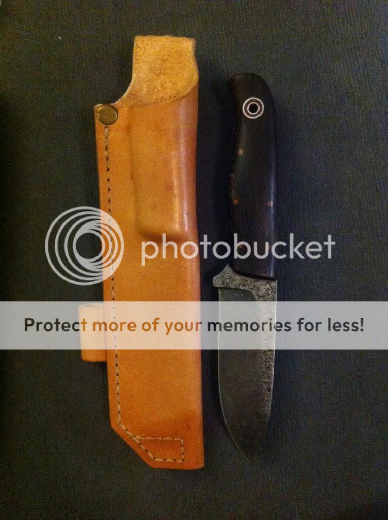

My sheath are naked, just vegetable tanned. M first sheath making attempt, was for my Black on black w/ blue pin scandi bushcrafter.

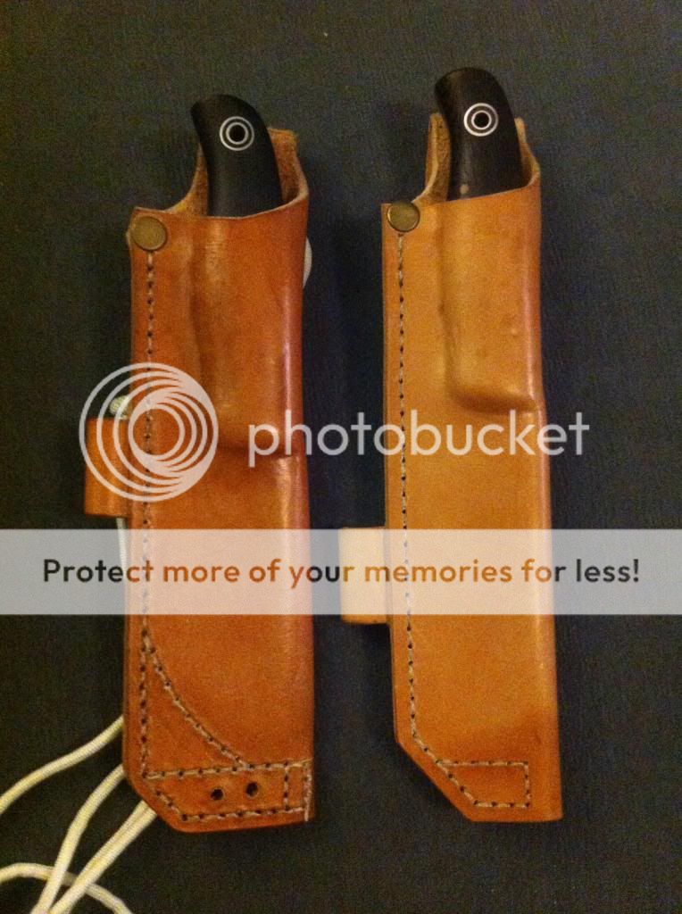

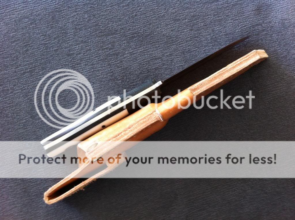

My second and third were for my xmas presents, that when with my full height grind rust burlap bushfinger (forgot to take pic of knife beside sheath before I gifted it); and my wenge saber grind bushcrafter(which was my favorite fiddleback!) I made a new bushcrafter pattern; they are not quite finished in these pics, wet forming and finishings...

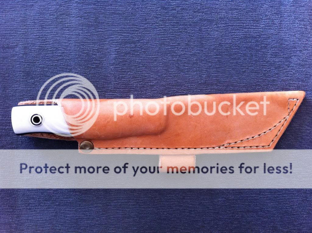

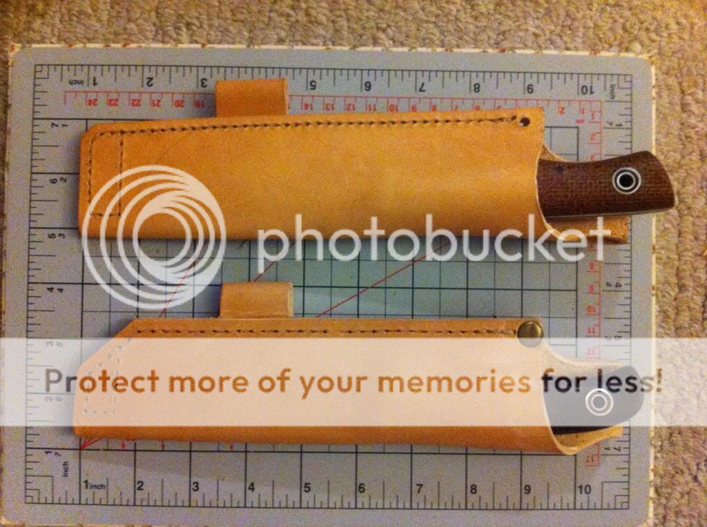

Here second bushcrafter is completed.

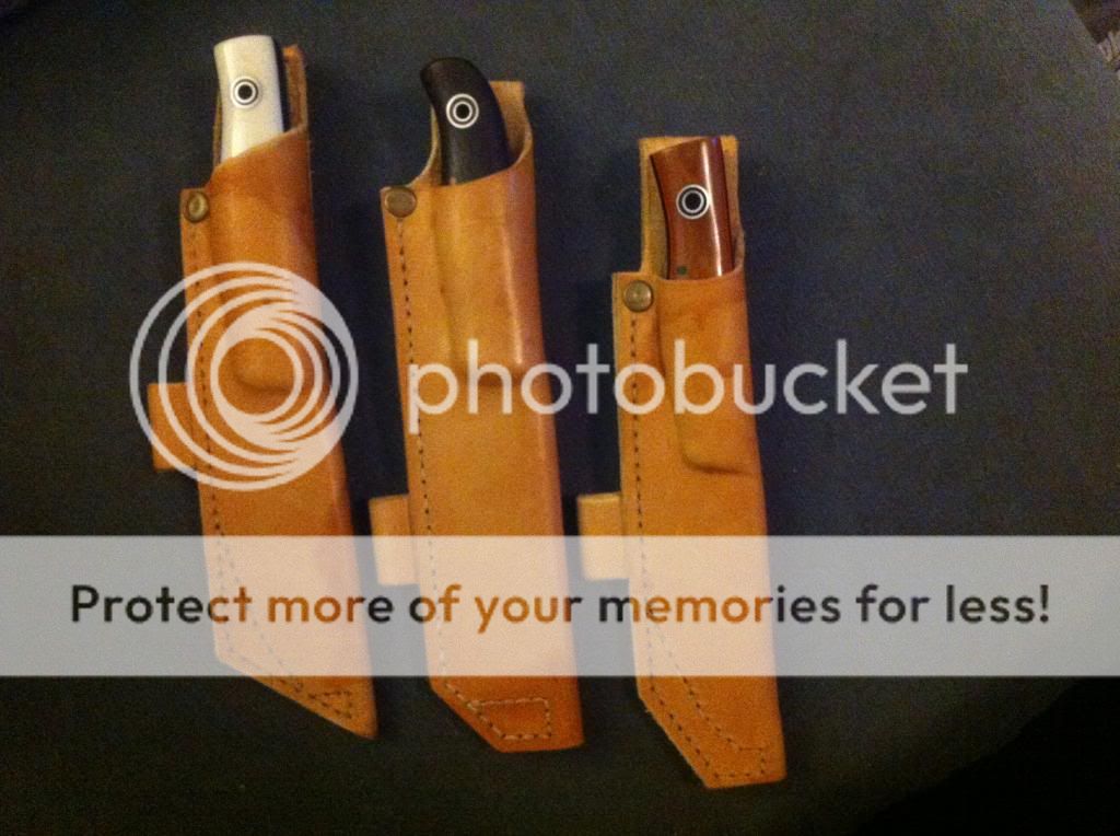

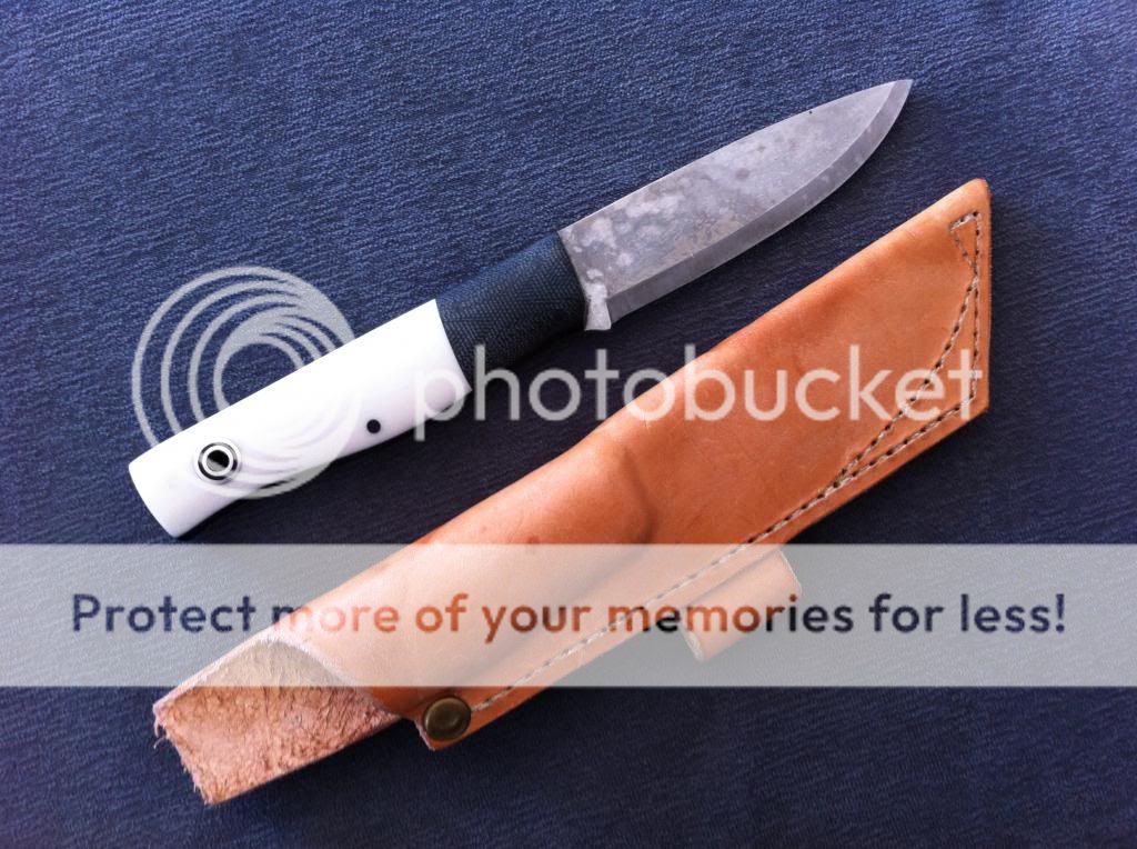

Sheath for my antiqued canvas scandi recluse and bolstered scandi terassaur where next, also make over xmas...
Still want to tweak some, but I'm happy with the bushcrafter and recluse. Have to make more yet, just need the time, become scandi hiking buddy and curley cue hunter...
I keep meaning to grab some D-rings and make danglers too.
