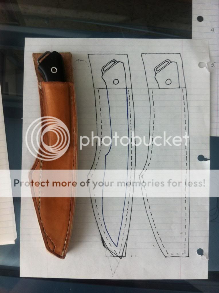

You may have to reduce your existing belt loop to fit your D-Ring - and you will need removable ones.
May I toss out a few things?
1) After much research most old timer leather benders have found that the rivet doesn't strengthen the opening of the sheath. It can be used for safety (as you can't cut through those as easily) but they should be known to be mostly for looks.
2) The straight lines seem easier to stitch - but they are just as easy to round off. Al Stohlmans book on Making Leather Cases shows how he makes a sheath - it was indispensable for me.
Your leather is plenty thick and I am certain that your work would be bomb proof and do the job it was made for for a very long time. Great first efforts for sure!

pretty darn good first attempts blood. thanks for sharing.
is that a shell-casing ferro rod cap? never seen than before. pretty cool idea.

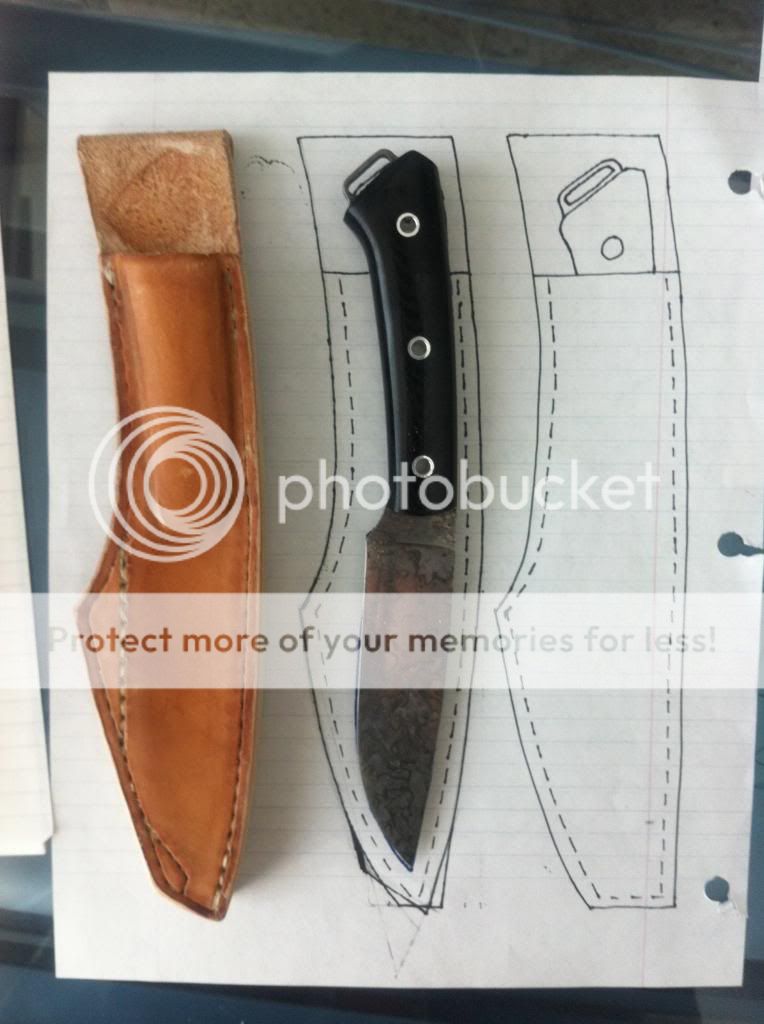

Thanks guys, Yeah the rivet is just for looks. I mainly did straight lines cause I didn't want sheath that looked like like everyone else's; with rounded shapes. I'm the same with cars, I think most of the modern ones are to round and bubbly, I wanted square, sharp lines; sheath that look like the could cut things too, haha
And the leather is very thick, lucky I have a "yankee handyman" that makes short work of putting holes through three layers at once!!

blood- I've spent some time looking at your work and feel that you've got a good start. My thoughts are always to begin with function and then go to form. You've pretty much got the function part done. There are a few points that will help it all come together easier and better. Might give yourself a little more room on the sew line away from the edge, for one. I can't really see how thick the welts are, but looks like they're same as the body. That's good! Like Tal said, if you're going to do a dangler, you'll probably need to narrow down the belt loop. Might be a good reason to do a different style belt loop rather than the folded over style:). Tal uses that style and spends a good bit of time working the flesh side of the leather to make it smooth and attractive. Now that gets into form and finish.
I do have an open ended question about wet molding the handle area. Now this is only a question, but one that I've wondered about. How will that hold up if you fall in the river at the beginning of a trip? Does it maintain shape and hold the knife after total soaking? I used to do it on all my pouch sheaths and always wondered about that issue.
The leather its self, is 1/8" thick; right now the seem allowance is a 3/16" from outside edge of sheath and a 1/4" from blade edge on inside,... are there some rough number that would be better?
And welt, it that the strip sandwiched in the middle to protecting the thread? Its the same leather as the sheath and is about 7/16" at is narrowest... I say that because I trace it out so that it follows the blade edge in, mostly to have knife sit where I want it to... not sure it it is necessary but I have fun with it!!

Curious about the work done to smooth out the fuzzy side of the leather... Was just wondering, ever time I pull knife out it has little bits of leather on it, not a huge deal but would it help to smooth all the inside or would that just eventually happen again and just a part of leather sheath?
That thought hadn't crossed my mind before... So I filled the tub and tossed my first bushcrafter sheath with knife in; after a moment I pulled it out and stated shaking it upside-down, held it like it did before, so I tossed it in again... repeated process and knife still stayed in...
So in it all went again, this time when shaking the knife popped out so I quit and left it all to dry. After about 25 min I checked on it and tried shaking knife out again but it stayed in.
This was all with my first bushcrafter pattern, which I deemed to big for knife. So next chance I get I'll try with one I think I got a better fit with knife and see how that goes too!!

I buy my leather from Roger Folmar at RJF Leather, 607-742-8969, top quality, very consistant, dyes and forms well. He sells double shoulders which may be more than most guys want since that's about 12-13sq/ft each piece. The best thought I can give is to buy the very best you can. Cheap leather only makes the project more difficult. The second thing would be to not buy bellies. Belly leather is very soft and the fibers are stretched and hard to work with. It is less expensive, but refer back to thought number one.
blood-Sounds like you're using 7/8oz. leather which is normally 1/8" thick. That is the same that I use for all sheaths and gun leather. For some of my other products I use 4/5 & 5/6 which are thinner. For small, light knives the thinner 5/6 works just fine. I know Heber uses 9/10oz. and I think Tal does as well. Like so many things, there is no "right or wrong". It's what you like and what works best for your purpose at hand. That fuzzy back side is the flesh side of the leather. You really want leather that has fine, tight grain on front and back. If you have nice tight grain on the back side, you can dampen the leather and use a smooth round tool (mine is an elk antler tine) to rub it one direction and get almost as smooth looking as the hair side. When this gets kicking, I'll post some wip photos to show some of my steps. The first is drawing the pattern and sew line. In short, leave yourself 3/8" for the welt. This will give you 1/4" from the edge to sew and 1/8" of welt next to the blade. Of course, you can allow more if you want.
Never dreamed my question would get somebody to throw their Fiddlebacks and leather into the tub! Guess there's nothing better than a practical test. It was only a thought.:D
