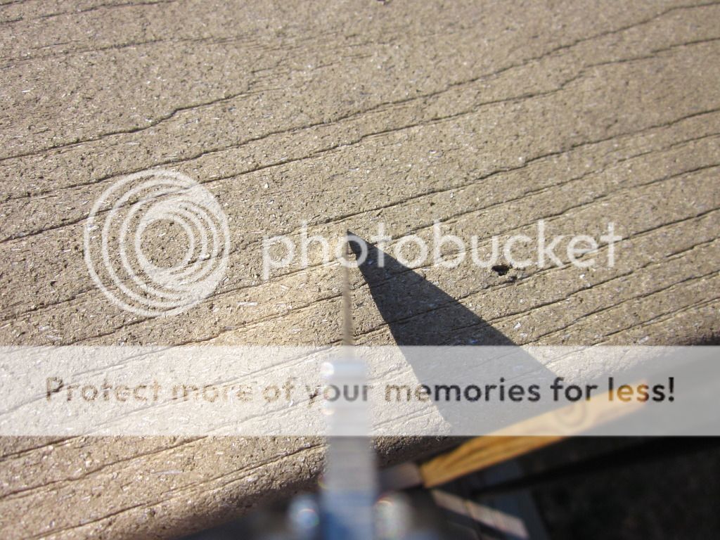

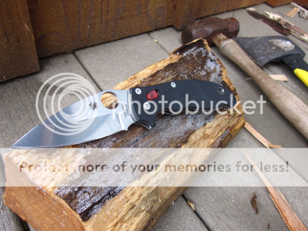

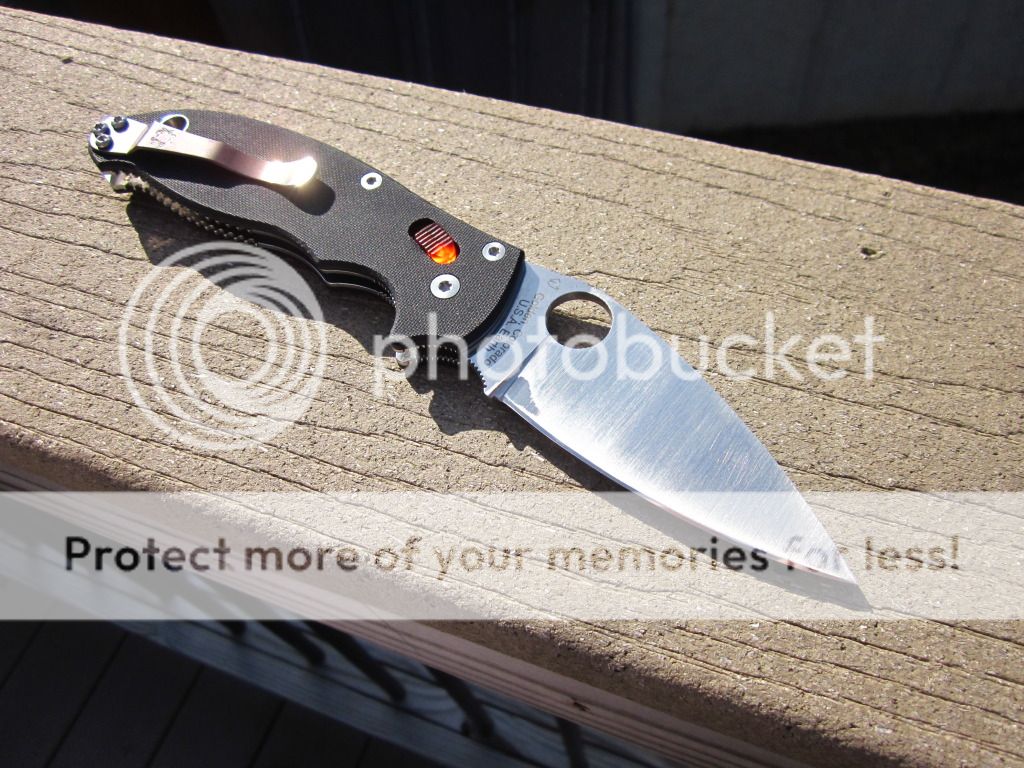

Well I decided to do my first re-grind yesterday. I love everything about the Spyderco Manix 2 but the grind. I absolutely hate the shallow hollow grind and had thought of turning it into a FFG a couple time but could never muster up the courage to take it to the grinder and potentially ruin my blade. Well I did it and I think it came out pretty nice for my first re-grind. I missed a spot by the plunge line on each side of the blade but I was pretty beat after 3-4 hours of grinding and I can touch it up later. I also need to take it to the 500 grit belt and get some of the deeper grind lines out. I just figured I'd show it to you guys in it's almost complete state.
Before:
After:
Very thin behind the edge.
Overall I'm very happy with it. If you've ever thought about getting your hollow-ground M2 but didn't think it would be worth it, DO IT! It is most definitely worth it.
Thanks guys! I appreciate it.
I used a Craftsman 2x42 Belt sander with a Norton Blaze 60 grit ceramic belt to reprofile. It was a very long process and I was extremely careful not to heat up the blade. I did one pass, then dip it in water to cool it it and repeated that throughout the re-grind.
