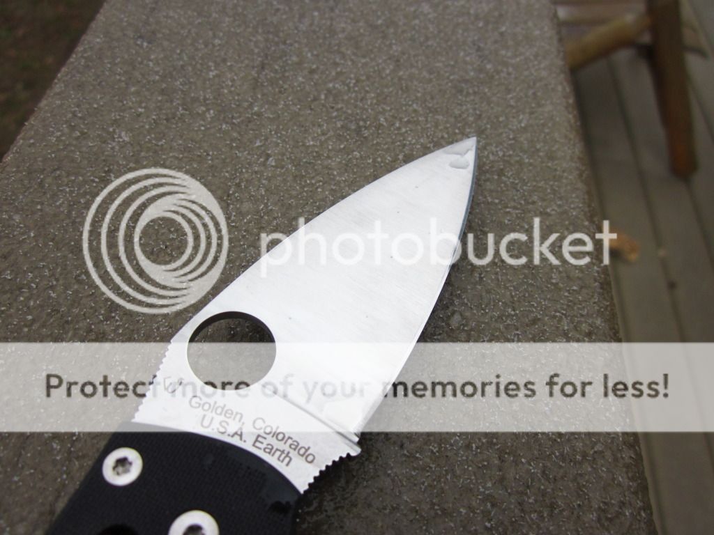

I re-ground my Manix!

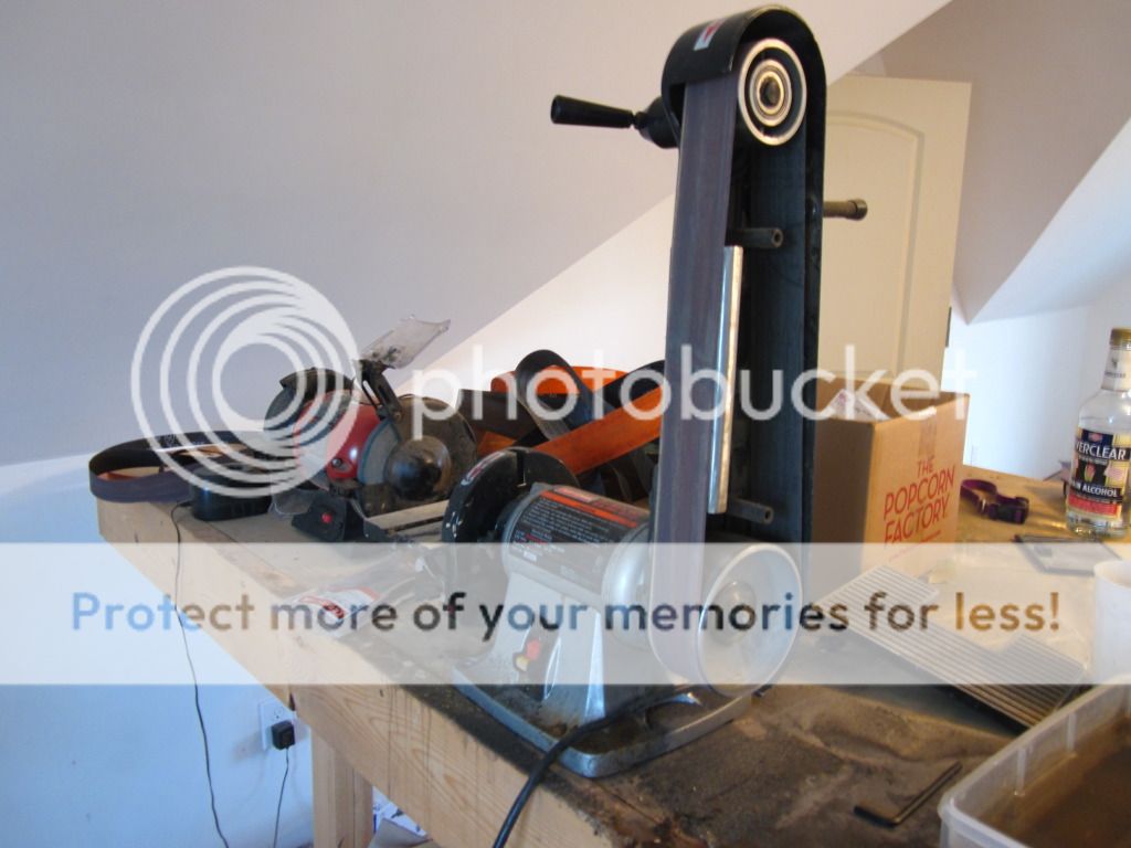

I've had people show me the solution to that on bigger better grinders. They put a felt, scotch-bright, or other slightly squishy belt under the higher grit belt, but the guards dont leave enough clearance for that on the craftsman. I haven't gotten up the nerve to saw mine off yet, seems like it would weaken the thing.

Good question! I didn't do any calculations or measuring. Just thought it out for a very long time before hand and watched a few videos of people regrinding knives. The first part of the blade that hit the belt was the shoulder where the flat part of the blade turns into the beginning of the hollow grind. I ground that part for a little bit then rocked the blade back a bit (So the belt is hitting more area towards the spine, not just where the flat and the grind meet) I just kept most of the pressure centered in the middle so it stayed fairly even from spine to edge. I never took any steel off of the edge itself. as far as I can tell from my sight and fingers, it's totally even. Sorry if that made no sense, it's hard for me to explain.
I actually took it to the 500 grit belt tonight. it looks much better than before but it still has those two areas at the plunge line that didn't get hit but I think I'll keep those to remind me of my first regrind. I'll take some pics tomorrow.

Here's some pics. It's cloudy so my camera wouldn't pic up the lines very well but you can kind of see them.
Here's what I was working with for those of you that were interested. I know it's dirty and gross.
Very nice. I think it looks pretty good. I give you credit for trying it on a not-so-cheap knife in the first place.

Thanks! I don't drink the everclear. I have before though(Don't do it) I actually use that to flame anodize Titanium and steel parts.
Looks amazing seelow! It actually looks better than my tenacious and it came ffg haha.
Thank ya Swoop! I found the Tenacious had kind of a swirly or blotchy pattern in the grind in certain lights. Never appealed to me. SAying it looks better than a factory ground knife is a huge compliment to me. Thanks!
