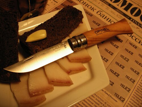

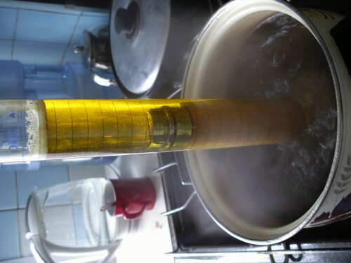

I only use my Opinel in the kitchen:

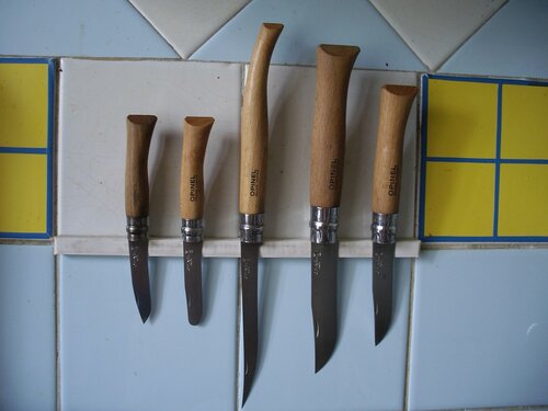

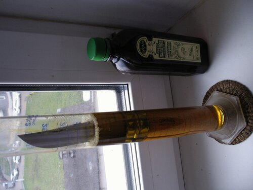

beech on the handle is stabilized in hot linseed oil:
all knives are not less than three years, I am happy :)
,I forgot to add that before hot oil hour I keep a knife in the freezer (vacuum precisely :) Polymerization of 5-7 days.
