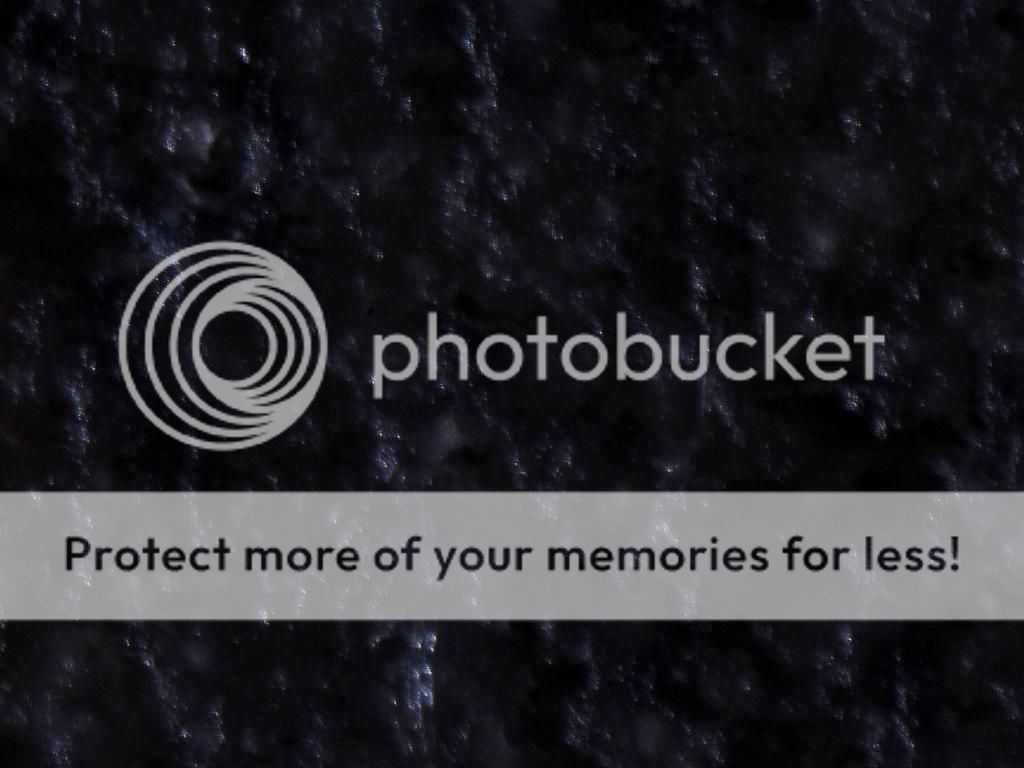

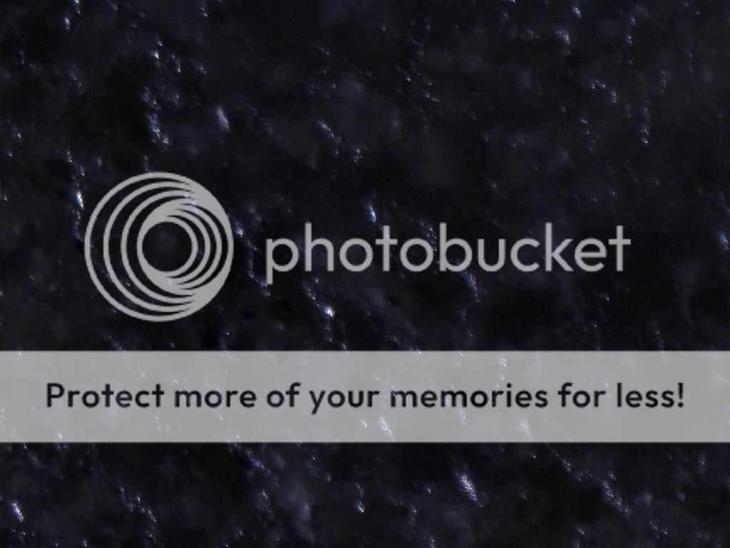

Just a couple more additions to give guys an idea of the difference between a loose grit lapping and a diamond plate lapping. You can easily see in the scope photos how much more sharp and open the surface of the stone is. The shots are lit with raking lighting from the side at an oblique angle to give a bit better idea of the stone texture. This is a Washita stone lapped with 120 loose SiC grit and with a 140 grit Atoma diamond plate.
Here are the stone surface scope photos.
Atoma 140 grit diamond plate lapped (smooth rounded peaks, very flat so swarf will constantly be in contact with the steel etc.):
WashitaAtoma140Lap.jpg~original
120 grit loose SiC lapped (sharp, jagged edges, open and gives swarf some room to get away from the steel):
Washita120SiCLooseGritLap.jpg~original

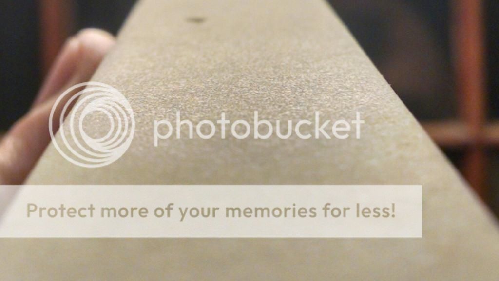

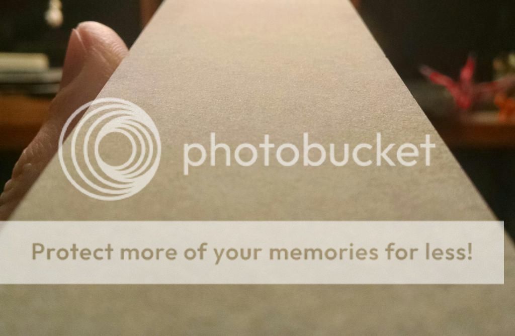

And the stone surface photos with my phone's cam just to give an idea of the closed/open condition of the surface by reflectivity:
Atoma 140 lapped (Note how shiny this is compared to the SiC lapped surface):
IMG_20150128_033010.jpg~original
120 grit loose SiC lapped (Note how much more matte this surface is):
IMG_20150128_033116.jpg~original
The loose grit lapped surface cuts like a BMF, while the Atoma lapped surface cuts meh.
The diamond plate conditioned image shows what I would call "glazing" - has been surfaced down to a finish that is finer then the abrasive structure. The second is more open due to the loose grit rolling around. Another consideration for those lapping with SiC is that when ground between two hard surfaces it will fracture down in fairly short order into much smaller pieces. If you want the more aggressive surface you will need to add fresh grit and pay attention to the slurry.
Also to consider is the differences in various stone compositions and how that affects what kind of surface you end up with. On my ceramic, the SiC could flatten the surface but could not really generate aggressive surface features, at least not in the order of what the diamond plate can do. The fine ceramic is by construction no more than a really hard material with surface texture added. A Wahita stone or vitreous stones have an open abrasive structure that breaks down somewhat in use and tends toward an equilibrium between abrasive potential and wear rate.
When I lapped and flattened my ceramic stone. I did my Washita stone as well, both in the same day. I noticed the Arkansas was cut and leveled Much easier than the ceramic using a coarse dia diamond stone. I'm certain one could level a Arkansas on a flat area of concrete but this would have little affect on the ceramic stone. Secondly, I've been paying attention to my ceramic stone in how it cuts during use and have noticed it cuts slower on the ultra fine side than the fine side. Still, this was to be expected after refining it's surface. Just a common out come. DM
Heavy, that shiny, slow-cutting, dull surface is exactly the surface you will get on your ceramic if you surface/flatten it with a diamond plate - unless you do all the flattening then switch to a brand new diamond plate for just a few seconds. As far as the SiC breakdown, I already noted exactly that, as well as stressed the importance of recharging the lapping plate in an earlier post. If you don't refresh/recharge the lapping plate, of COURSE you won't get any aggressive surface characteristics. You are effectively lapping with a much finer grit than you started with. You must recharge MUCH more often when lapping the ceramic because the SiC breaks down rapidly.
