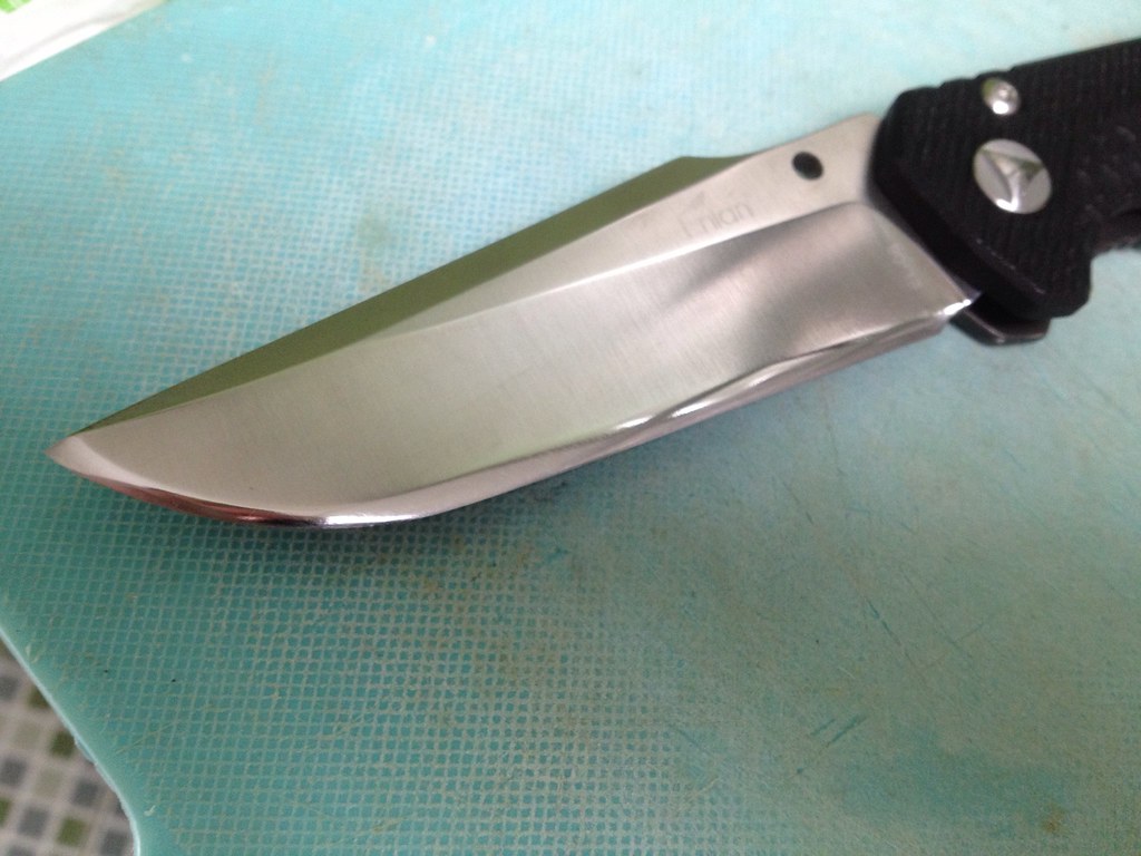

Following the good advice, yesterday and today I retrace back: DMT C, F, EF, WB + 3 layer paper + black compound (thanks bluntcut!) and BS + autosol.
Result:
Balance Strop is an idea from bluntcut to have easy stropping and not much rounding of the edge. You might want to watch his video to understand why.
And of course Washboard from HeavyHanded. I put the black compound using Magnanimous method (oil rub to compound then rub the softened one to paper on WB).
Just tested, hair splitting (though not across full length), so it's good enough to be back into EDC. No pics though, bad ligthing, and I hate flashlight photo.
