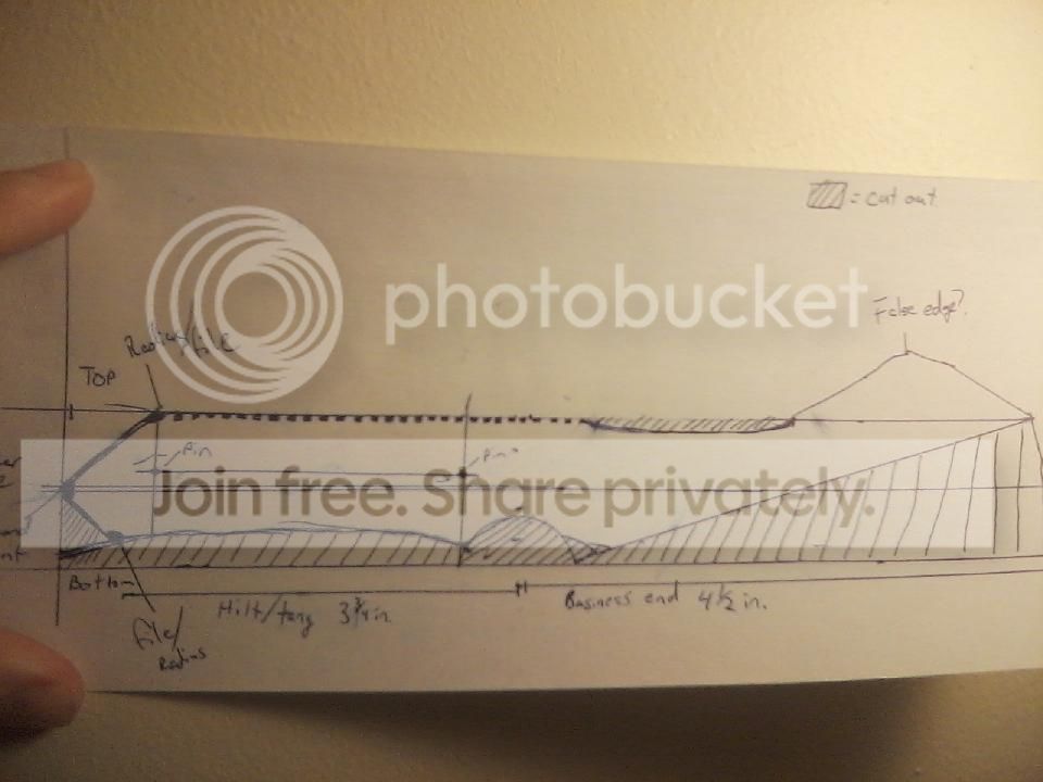

I've got a rough sketch that I brainstormed this afternoon and if you guys wouldn't mind, pick it apart. I have a feeling the response is going to be something akin to me going over to the aforementioned website and proudly displaying my Vulcan AR15. So, hit me with what you've got. I'm all ears! Thanks to the site for having me. Here is the sketch.
I'm not entirely sure what I want to do with the tip. I may make a slight (undercut?) near the tip as I have it in the drawing...not entirely sure. I'm open to suggestions.

Knife Design:
Think thin.
Forget swords, Saw-tooth spines, guthooks, crazy grinds and folders for your first knife.
Start with a drawing.
Show it to us, we love to see and comment on photos.
Then make a cardboard cutout template & draw in handles, pins and such
Then use wood, paint sticks are free & close to the right size.
If it “feels right”, it usually “looks right“

Since you've already got a drawing, I'd suggest you cut the outline in wood, like paint sticks - they're free.
On that particular design, think about rounding off the corners on the handle so they don't rip your hand open.
While your knife looks interesting, it is not going to be a good first project. Please don't take that wrong, but something simple is the best way to go. Let me put it this way. If you were going to create a gun from scratch, assuming you had all the tools necessary but none of the experience, are you going to start with a pistol or a target rifle with a 30 inch barrel? Start simple. Make something small, work on it much longer than you thought you would need to, do everything as well as you can, and you will have a knife that you are proud of at the end of the experience. If you rush it, like I did to my first few, you won't really like it. Start small and then work up to your dream knife. Just my 2 cents.

Thanks for the tip. I'll look into paint sticks. I will be rounding out corners as needed.

Thank you as well. I thought it looked awesome. I read earlier about certain types of points you can put on a knife and dagger points, which that kind of qualifies as, if I'm right, will and do snap off with regularity. I hadn't really planned on using or gifting my first one. It was more of a proof of concept for me; can I do it, sort of thing. I may end up going with a more traditional point if I decide to make this a utilitarian knife though so thank you for the input.
I'm assuming you're saying it wouldn't be a good first project due to the design of the blade, correct? If not just that, what is wrong with the handle?
No offense taken to your post. That's why I'm here! Thanks!

Welcome! Your blade design looks interesting to me. At first it looks "tacti-cool" but as I look at it a bit more I see a traditional handle shape on a stretched out kiridashi. If you take the blade edge a bit steeper, closer to maybe 40-45 degree from horizontal, it will give you a stronger tip and shorten the blade. I think with a few tweaks you can have a design that is easy enough to make for a first timer and one that (with proper heat treat) will be a good user.

As you may be able to see, I have the blade to about 4 1/4 inches. I was seriously considering lopping off 3/4 of an inch on it. It would almost be a EDC type knife and would meet legal requirements for length in a lot of places. Thank you for the idea and angles as I'm not privy to such a thing....yet. I have never bought anything higher in quality than a baseline kershaw and honestly, never really looked at anything seriously. I did not mean to rip off any designs if I did. Just something I brainstormed.
I have to ask about the edge I was thinking about putting on it since I didn't mention it, and I don't know all the nomenclature of blade making so here goes; should I stick with a two sided edge or would I be ok with going with one side completely flat and the other one ground to an edge?

I don't think your shape will work in reality. Lots of things look good on paper. The tip would never survive use...if it even survives manufacturing. The handle looks uncomfortable.
I would suggest you look at some knife photos and pick out a simple drop point hunter that you like. Draw it out and keep the design as simple as possible. Forget whistles and bells, like filework, false edges, and fancy butt shapes. Just have a basic 3" blade and a comfortable 4" handle. That alone will be plenty to master on your first knife.
There is a good tutorial in the stickies about making a first knife project.
Work up some more sketches and post them here. The guys in Shop Talk vary from new makers to old pros. They will offer lots of good critique. Take what you want from that and tweak the design until it seems right.
