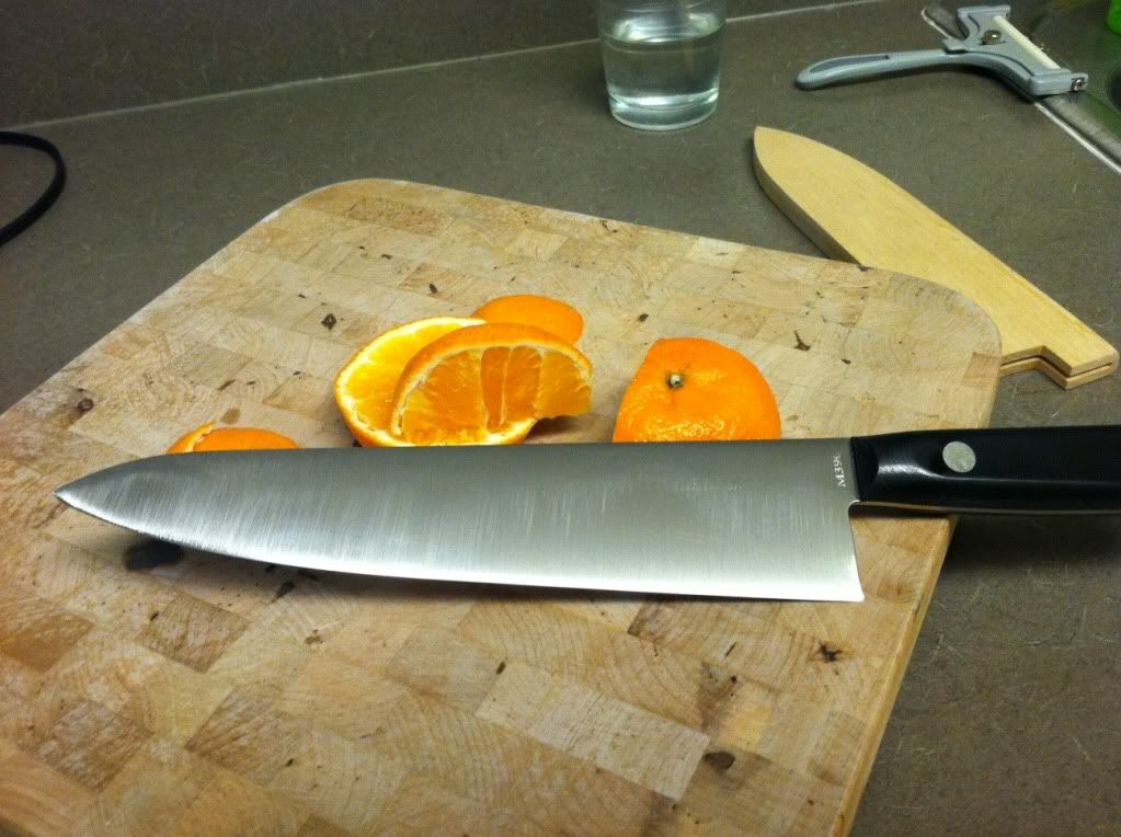

I took my M390 Artifex to the grind last week. It was fatter than I thought (.025 at the shoulder ) and now it is .012. It took a bit of work as I took it to a flat grind then restored the convex grind. It is so thin now that the saya slides right off Thank god for Blaze belts!
First attempt but not thin enough
Second attempt with a bit more steel removal.
how is it now after your tweeking? just curious, if i were to get an m390 artifex, how much would you charge for your thinning service? =D
With the convex grind restored I have had zero problems with sticky potatoes, yams and celery. I do however have a bit of resistance with slicing as the 220grit finish is too coarse. I think norax belts would help level it out.
