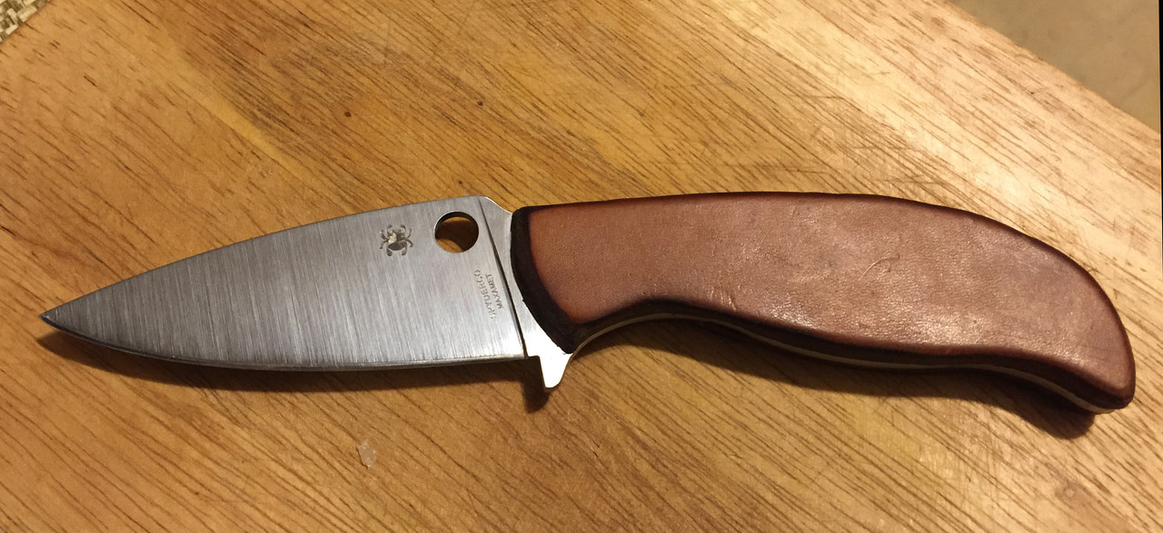

Leather is very easy to work with, easy to attach, and comfortable in hand.
I used it as a temporary handle for a Spyderco mule, but liked it so much, decided to keep it.
This one is two layers.

This looks great! How did you put this together?

That leather grip is VERY interesting. Nice job. How do you "round" the edges of the leather around the periphery of the grip...or do you just use a "scalpel" to shape it? BTW...love those mules...
If you mean shaping it, I just glued them on a little oversize and cut with another knife.
If you mean contouring the edges, I left them square and burnished with a piece of bamboo. I've been meaning to bevel the edges more.
This was done in a hurry, probably under an hour... not counting time for glue to dry.

By the way dampening the edge with water and burnishing with some cloth such as denim will generate enough heat to make a professional edge and create a nice sheen. Depending on degree of dampness and heat generated it can even take on an interesting darker color ;)
Impressive work done in a hurry... looks nice to me...

Forgot to add, I used neutral color shoe polish for the burnish.
I can see that wetting the leather would allow it to more easily compress resulting is denser material that would build up heat faster. I might try this next time.
BTW, I'm no leather smith or anything like that, just a DIY hobbyist.
