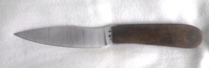

I want to add a thin "handle" to a blade.
I went with the leather and used Gorilla Glue. Seems very stuck.
Crappy phone pic doesn't show the grain very well.....but...

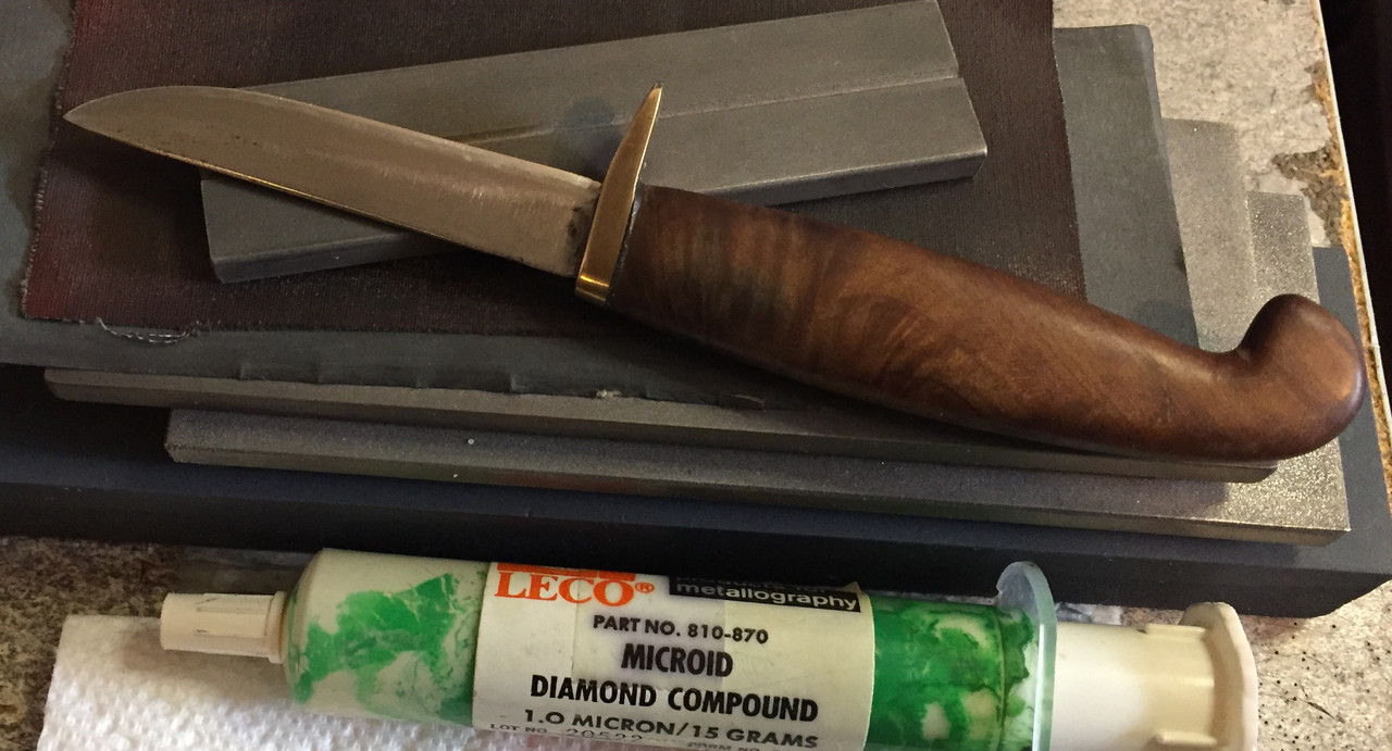

Use it with reckless abandon and see how it holds up. You might end up finding it more desirable than conventional slab scales. ;)
I use a leather conditioner on them one time only. The stuff I have is an old bottle of Meltonian which is excellent. I've heard the formula has changed, so no guarantees with the new stuff.
If the gorilla glue comes unstuck, try the contact cement.
I've been using contact adhesive ( like the stuff used to laminate formica counter tops) to glue my leather to my wood handles to make strops.
Apply to both surfaces, let both dry and BOOM! You ain't getting 'em apart.
It might need that expansion to make a lasting bond. Contact adhesive does not require any expansion what-so-ever.
Never has.
Gorilla Glue does expand to fill small voids. But from what I've seen, it doesn't actually need that expansion to work well as a bond, and likely is stronger if it isn't allowed to expand much, if at all, within the joint . I used it to glue brass tubing into lanyard holes I drilled into the handles of three Opinels of mine, all very snug and perfectly fitted to the 1/4" O.D. tubing I used. The bond is as strong as can be.
In one instance where I used it to glue a brass rod into the endgrain of an oak dowel, the hole I drilled was somewhat loose for the rod. The expansion of the Gorilla Glue to fill the 'slop' in the drilled hole made the bond weak, and I found out later I was able to twist & pull the rod out, when testing it for strength. The glue forms a lot of bubbles and gets very foamy-looking when it expands out of a joint or into voids within the joint, but loses a lot of it's holding strength after doing so.
Woodworkers sometimes use polyurethane glue (generic name for 'Gorilla Glue') for joinery, in connecting surfaces which are jointed or planed flat & smooth before gluing, with little or no gaps or voids to fill. I'd bet that's what makes such joints strong in doing so.
I....theorized.... that the Gorilla Glue would ...try... to expand and since it was leather, could possibly invade some of the material itself and create an even stronger bond.
I use GG on bonsai when I break a limb. It expands with the growth of the tree and can be trimmed and painted to match the color of the bark.
In looking online, reading more about Gorilla Glue, I found a woodworker's page (link below) with a review of it's gap-filling characteristic, and how that affects holding strength. In short, he confirmed what I'd assumed, that the 'foamy' character of the glue, in expansion, makes it very weak. Of interest in his review, he also quoted a response from the makers of Gorilla Glue, in which they explained it's best-suited to tight & clean joints, with little or no gaps to fill (and they recommended their Gorilla epoxy product for that). They also mentioned Gorilla Glue is designed to penetrate into the material to some depth, making the bond stronger. The quoted reply from Gorilla Glue's mfr is at the bottom of the linked page below.
So, long story short, it looks like your theory is on target. :thumbsup:
https://woodgears.ca/joint_strength/gorilla_glue.html
