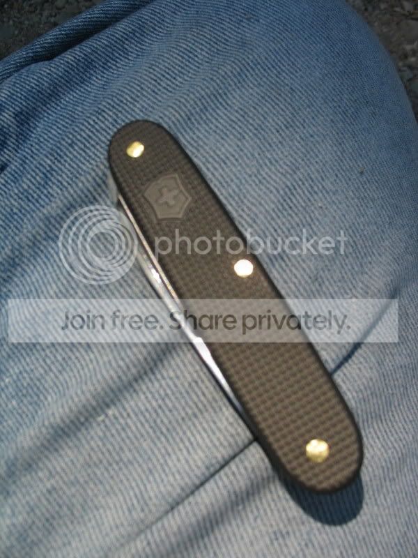

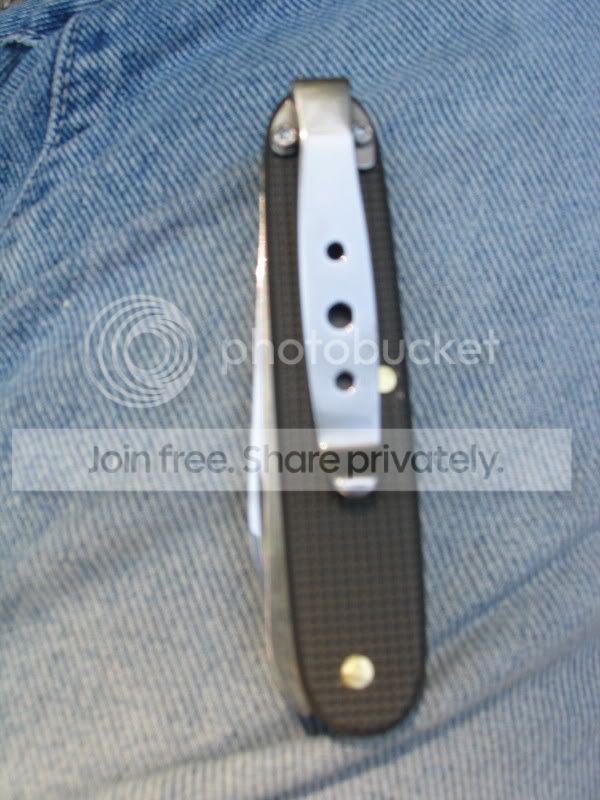

I'd second talking to Scibeer over at knife forums as he's a wealth of knowledge on modding SAKs and has been great with giving tips, etc. Here's a Farmer he modded for me at the bottom of both pics. Felinevet and him did a special run of HA III Alox scales for the Farmer and I got him to add the scissors and pocket clip to mine.
