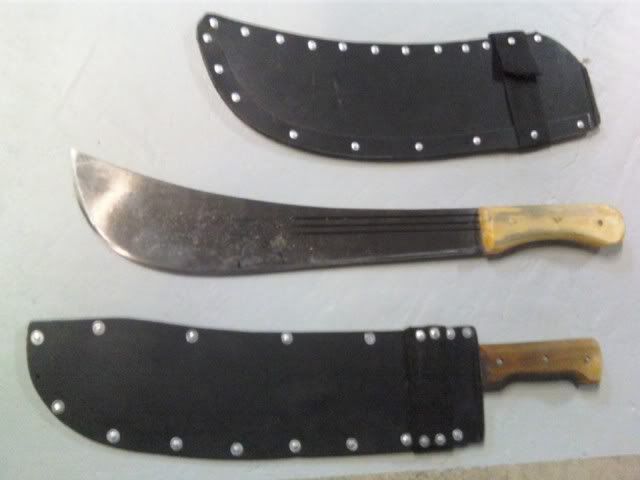

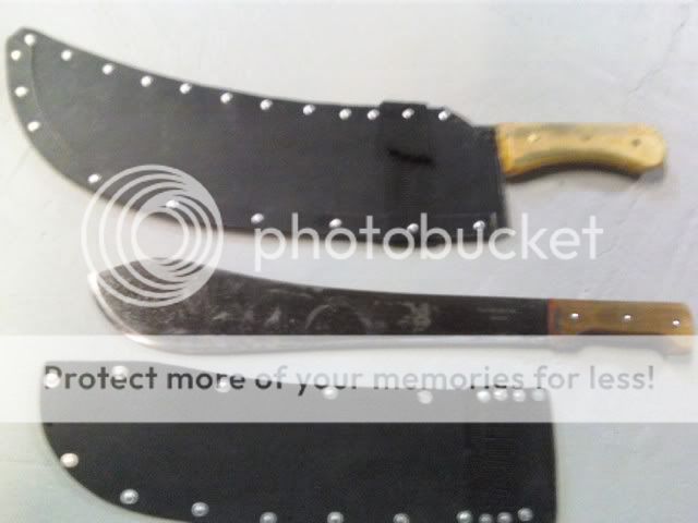

I made a few out of the sides of a Rubbermade trash can. Cut the overall pattern and added a spacer along the spine, making sure there was room for the widest point of the blade to fit past the throat. For rivets I used aluminum nails, just pound it through, clip it off about a 1/16" above the surface and peen it over. Nice and light. I added a band of webbing, riveted in place, around the top for a multi-use attachment point.
They're terrible pics, but here's two I made just to give you an idea.
Nice looking sheaths, HeavyHanded! This sheath is for my 24" machete that is going to clear brush. I doubt that it will go hiking anytime soon but you never know what could happen! I would use chicago screws for my sheath because I will have some left over from other projects. I am looking at instructions on how to peen a nail though.
