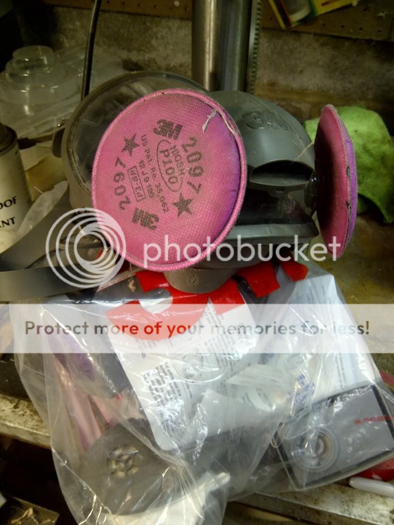

I have an old 3m and a newer 3m I have always used for micarta.
