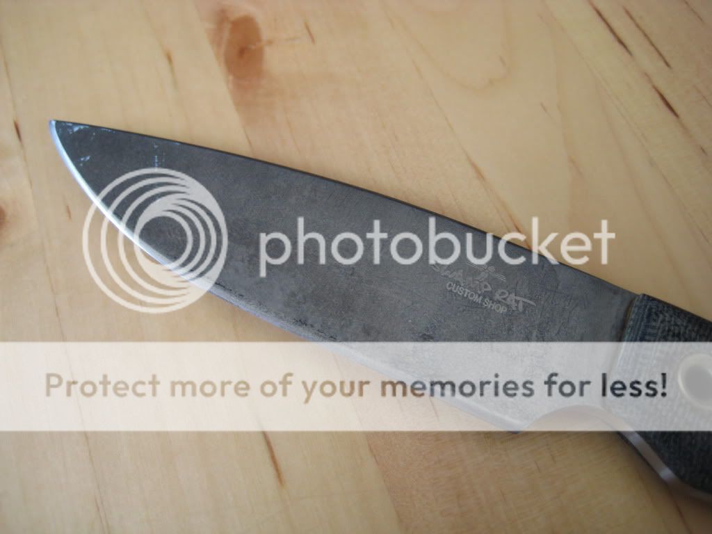

I'll post some pics tomorrow of my swamp rat vex. started of with stripping bark of a tree and the blade got stained...then i covered the blade w/ mustard to make it look better. i was pretty happy with the results but soaked it in cider vinager to darken it. few swipes on my strop and it was all good...the blade steel is d2 incase anyone needed to know.

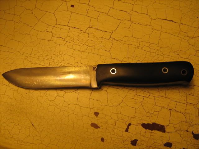

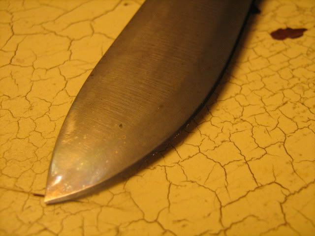

Cold Steel Norse Hawk, soaked in vinegar about 30 min. Nice, light gray. If you look at the toe and heel bevels you'll see some small areas of the original color that was masked by tape.

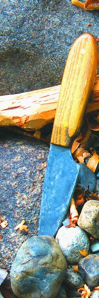

Sgt. Khadka Bonecutter etched with ferric chloride applied by brush (bottom):

heres my pics as promised of my swamprat...see above for how

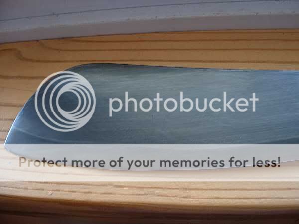

Sanded with 200 grit wiped with vinegar for the base patina then very light sanding with 400 and mustard finished blotted on with a napkin for the pattern
