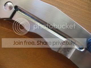

Does anyone know how to get that sweet-looking frosted "ice" like finish on titanium that I've seen on a David Broadwell framelock?

I'm not sure how David is doing it, but a vibratory tumbler produces the finish you're speaking of. You may have to play around with the media.
here's what I'm talking about, if you're unsure.
Sorry, that's not the frosted finish I'm thinking of. Without a better picture I couldn't say, but it looks hand rubbed to me. I don't know if he hangs around here, but I know he's over on Knet, so you might try posing the question there.
Hey, that's my pic! :D I'll try to take a better photo tonight. I seem to remember David saying he uses a rotary tool to accomplish that, but I don't remember the specifics.

Definitely not bead blasting! Here is a close-up. You can see it's just many, many overlapping "tracks" made with a spinning abrasive of some kind.
Much better picture! That makes it easier to see how it might be done. So, I am guessing that a pointed cratex bit randomly passed over and over the surface would yield that finish. Sound about right?

That's it exactly. Just drive a sharpened Cratex tip around randomly. I add some fine stone lines to spice it up.
