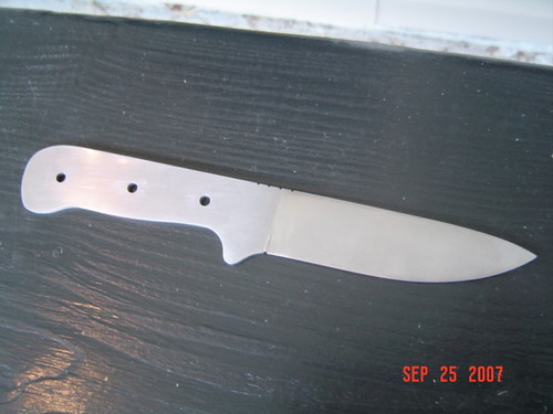

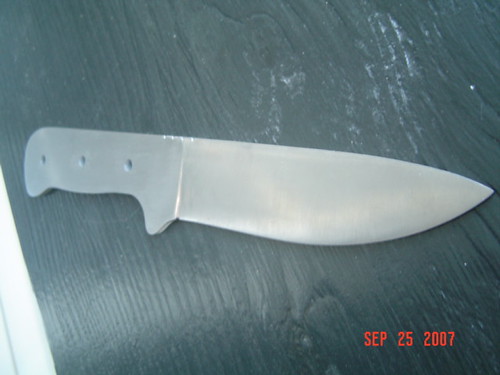

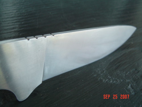

I am in the process of making my first knife. Here it is.
I haven't HT it yet...still figuring out the best/simplest/cheapest way to make a forge. Any suggestions for a first timer are welcome :D In the meantime, I am thinking ahead about the scales. I have some red oak, anybody have any experience/opinion about it? Any other suggestions? Any comments greatly appreciated.
Sorry, completely forgot the details... 1095 steel, 1/8" thick, blade length 4-3/8", overall length 9.25"
As a new maker you may be better off asking someone here on the forum to HT it for you. Several here will do it for a price that would figure to less than 20 bucks with shipping both ways. Whatever you use for handle material make sure if it is real wood, that it is stabilized. No sense in putting that much work into something that is not.

Nice blade. I Heat treated my knife in a camp fire at a friends cabin and quenched in canola oil (O-1 steel). turned out nice. Oak I find to be too porous, and a knife like that should have a fancier looking wood! I am fortunate enough to have a huge wack of 1/4" electrical micarta at my house. I got a sample of really neat looking hardwood floor that should turn out nice for a knife (needs planing [and stabilization]). I also went to a welding supply place and they gave me a free stainless arc welding rod and the flux broke right off, in case you need pin material. have fun!:thumbup:
charcoal is easy enough. I hacked a propane pipe forge for heat treating (modification of the one brick idea) and it's okay but charcoal is better for me right now.
I've done some oak handles with home stabilizing (soaking in wood hardener) and don't have any problems. You could hit up shadetree phenolics and get just about any look you desire, I've played with some samples and it's great stuff.
For pins I have used worn 1/8 drill bits, 1/8 brass welding rod, and nails all successfully.
make trial pins! fit and work the handle and take it off and work it down to perfect and fit it up again- my biggest hassle is when I don't have the front part of a handle perfect before I glue up.
