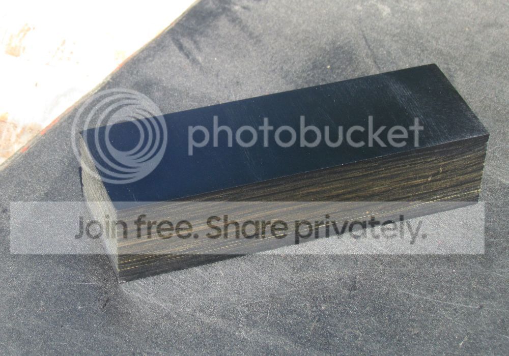

ID? Man made handle material, I don't know what this is.
Dec 7, 2008
7,187
First of all, I am not a fan of man made handle materials.
This piece of ??? came from the estate of Knife Maker Tedd Dowell.
I don't know if this is something worth cutting up or if it is junk.
I am leaning toward #2. But I figured I had better check before I toss it.
It is hard and heavy. Cuts and sands like a hard, hardwood.
Looking at the edges it looks to be constructed of veneer slices with something like hard epoxy.
The layers are about as thick as a business card.
Any of you guys who were making knives in the 80s know what this is?
Block sanded to 120 grit.
not sure from the pics but is that a wood laminate or some type of phenolic?? appears like both, and a little g10 liners for good measure :)

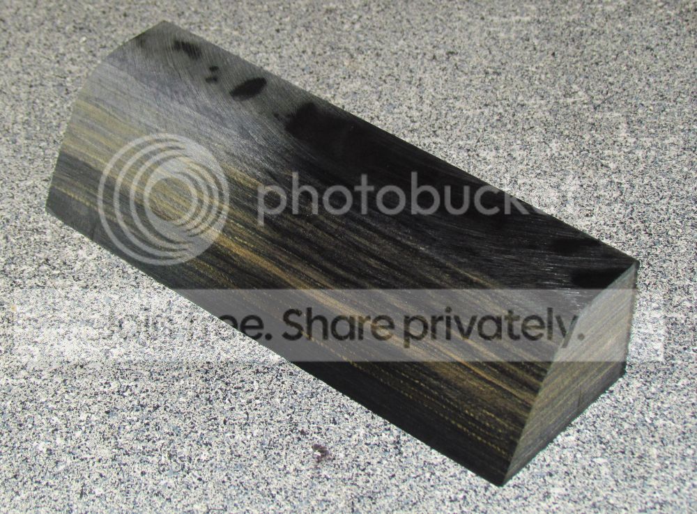

cut or sand an angle into it to reveal the veneer layers.
could be a homemade dymondwood of sorts
dont toss it

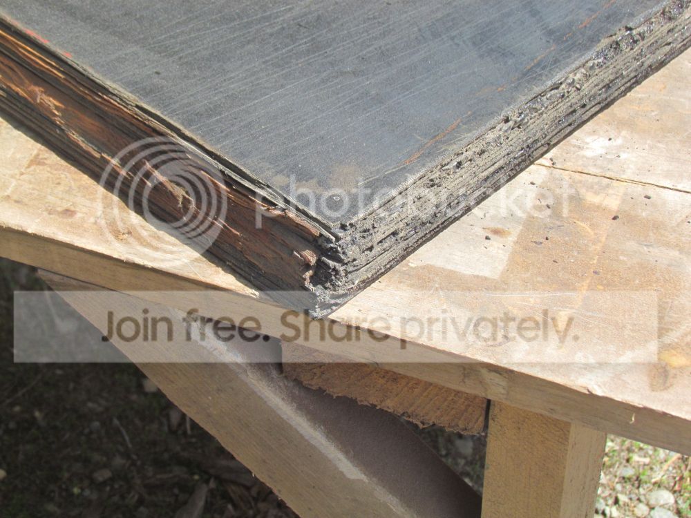

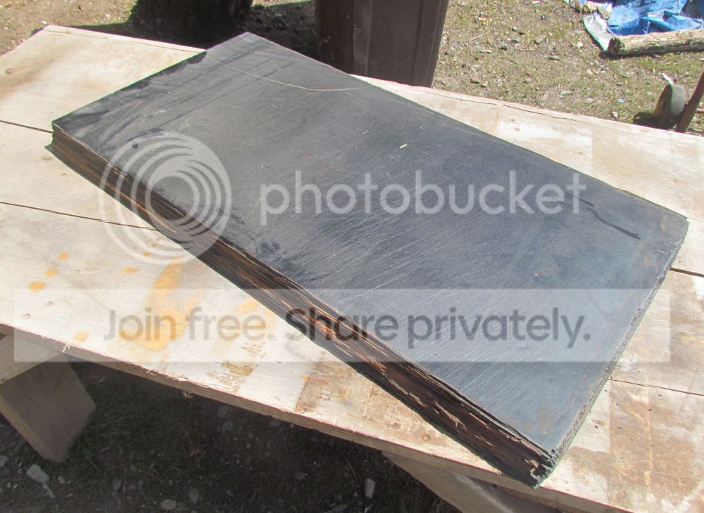

From what I can tell it is mostly wood layers but the cut edges look like layers of fabric as well.
The piece seems too large for something home made.
Here is an angle cut.
Is the top layer sort of slate-like? I have seen some hearth material that looks like what you show.
