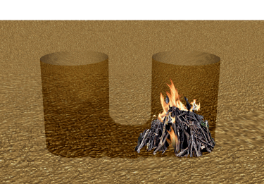

Basically make a fire log like in the video below but with a fatter log and blow air through the hole in the side.
[video=youtube;CNeOyoJK5EE]https://www.youtube.com/watch?v=CNeOyoJK5EE[/video]
If I had a hand-cranked blower that I could carry out into the woods I'd try it out and use a rock as an anvil.
Another idea: the Dakota fire hole. It naturally feeds itself with air and gets quite hot. I could also blow air into it through some reeds or bamboo or an aluminum tube or something. See below.
I think they would both work, but the fire log for a shorter period of time. If you hooked a thermocouple up to it you could measure the temperature.
The Dakota fire pit would just be a vertical forge, If you had coal you could probably get it hot enough to weld with as long as you could get air to it.

I'm not suggesting I'd set this up when camping or backpacking, just in the woods by my house for fun to see if it would work.
I might use some spring steel I found on an old car in the woods or an old tractor tine I also found, but I sure won't be grinding on a rock by hand... that could take a freaking lifetime.
Bamboo blow pipes do work, you have to punch out all the nodes except for the end one towards the charcoal which has a small hole in it.

on a windy day you can easily heat a 1/4 inch round piece of the steel they use to wrap bundles of rebar to a dull red or even a cherry red with just a regular fire, but obviously that's not hot enough
Why do you have to do all this in the woods?
If you do it close to the house, you have power to run the fan, that you can control.
You have water to put out the fire.
You have a phone to call the fire dept.
You have all your anvil, hammers and heavy tools close by.
If your into primitive forges that actually work I would do a search for Dogan African blacksmithing videos on youtube.
might need to find your self a goat skin or some plastic grain sacks to make bellows with...
