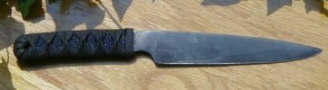

This is the A2 heat treat test blade. I had it originally set up for scales but since it was a test piece I didn't feel like putting alot of effort into finishing it. What do you think of this wrap job? This is a double wrap 0f 550 cord. I went around the tang twice. I crazy glued the front and back first two rows of cord to keep them from getting loose. What would be a good placement of drilled holes in the tang for 550 cord wrapping a handle? Thanks

this is what I had on some blades I took to the Blade Show - simple and easy to repeat, but if pulled tight, stays on nice and snug. Not for everybody - but worked for me.
That wrap looks fine but if you want a realy nice grip I'll show you how to do this one at the meeting monday. Drill a hole center of the but end of the tang.

Great ideas guys. Larry, I'll check it out Monday. Dan G. thanks for the link. Dan K. nice looking wrap, I would like a bit more girth, fatter wrapping around the tang. I'm thinking cord wrapped knives would be a lesser expensive alternative for my customers.

Here's a rewrap of the same knife. I like this method, more hand filling. It's from the Running Dog Knife Co.

Scott you can stack under it too to make it wider

I'll talk to Larry about the rayskin. :) I did the flat wrap under the top wrap like the instructions said. I took the knife to work and all the guys liked it. They felt it could be a good seller. I hope, because I could make these in a day if need be. Gun blued or etched O1 would be tough looking also. :D
