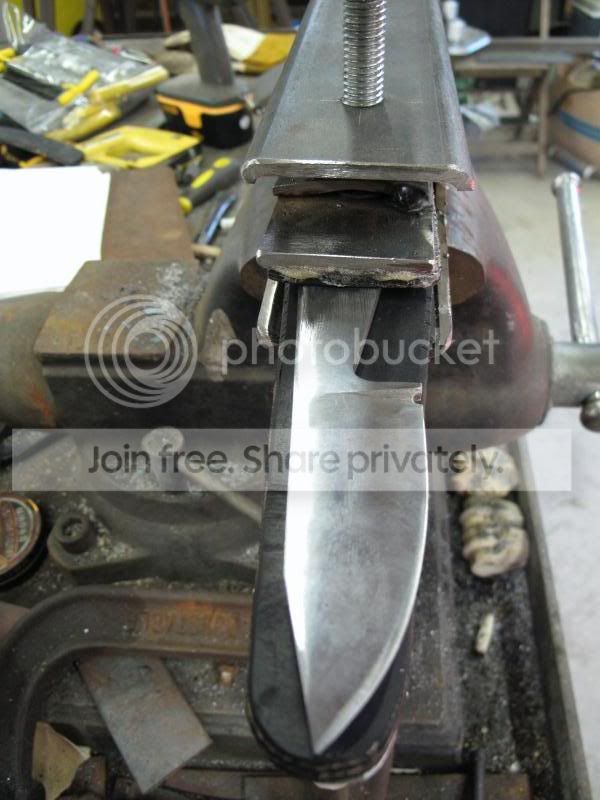

Here's what I use. It has worked out great for me:
It's just some thick weld stock I cut to shape and then drilled and tapped holes for the blade support. The set screws push up into the leather to support the blade through the distal taper giving a completely rigid setup for sanding (no springing of the blade). I just clamp the knife and support to my work table, and I'm set. I use a piece of angle iron with a true flat ground in for a backing stick for the sand paper. It gives me plently of handle and control. I also have another angle iron with leather wrapped around it for a softer cut.
To protect the blade while sanding the other side, make sure you tape up the side that is done so that oil and grit doesn't get between it and the leather support and scratch it up. I'll also just run a piece of tape over the leather sometimes if I'm not doing finishing work to minimize scratching.
I also position the blade so that the support is underneath the entire length of the blade so you don't stab yourself on the exposed tip while moving about.
I use incandescent and flourescent work lights to monitor my progress in scratch removal.
--nathan

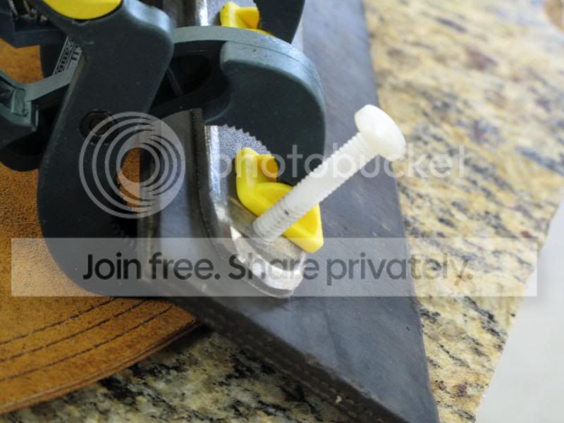

Here's mine.
It's a piece of mild steel with a rubber face and a nylon bolt threaded through the end. The nylon doesn't scratch the blade, but does well to support the tip.
That looks good as well, Vaughn. I have a knife finishing vise I can mount my jig in now as well. I ended up using multiple set screws (more than I needed as it turns out) so I have some flexibility when sanding longer blades like bowies. That way I can have two screws spreading out the loading on the blade to prevent flex.
I like the idea of the nylon screws as well.

Nathan, thanks for the kind words. To be honest, though, I actually modeled mine after yours. You posted those same pics in another thread, and I liked the idea, but had to work with the materials I had on hand. The nylon bolt was a left-over from another project so I used it as a pass-through tip rest because the rubber belting wouldn't flex like your thin leather does.
