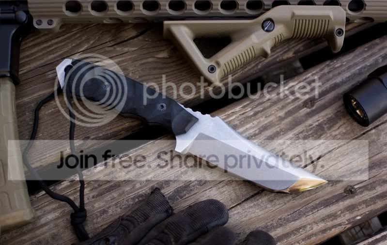

I love doing an anso texturing. I don't have a close up of the handle, but here's a picture. They look pretty cool, and are really grippy. (sorry for the super big images, I can't figure out how to shrink them)

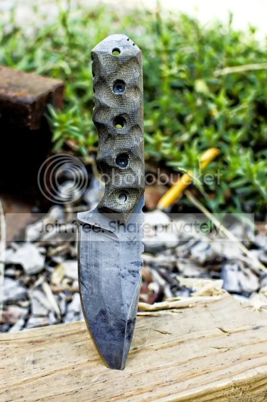

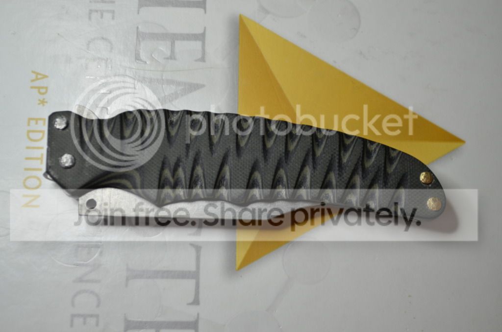

I use a dremel and do all kinds of different textures. I think its my favorite part of knife making. These are fixed blades but I have done some custom folder scales with the same style only on a smaller scale.
Here are a few different ones
