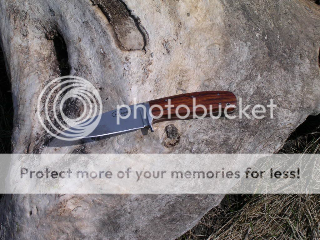

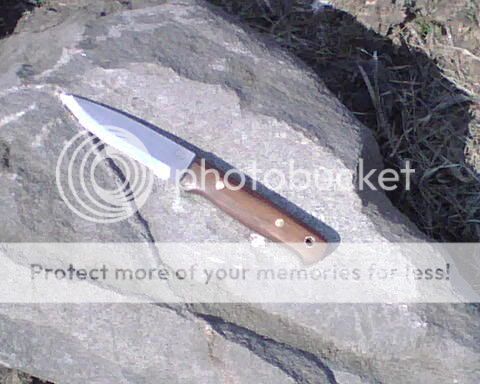

As a budding maker, I'm simply asking for your input on what constitutes a good bushcraft knife. NOT a survival knife, necessarily, but one suited to less-intensive tasks; one to be used in conjunction with a hatchet, hawk or big knife for the rough work. A knife that will be used for carving, whittling, food prep, cleaning game, etc.
I can't help but notice the similiarities between many bushcraft knives and the good ol' Green River knife like the one in the first pic below... my only real complaints with the GR are, the handle is too dang small, and I prefer a little something to keep my hand off the edge. I also tend to like a slightly thicker blade, as long as it's ground nice and sharp; I hope the second pic illustrates what I mean. Other than that, I think the criteria would be:
4-5" blade, of stock about 1/8" thick, to allow for fine slicing and carving. How big/thick is too much? Most likely a full flat grind, for the same reason, although I love convex blades, too.
A nice drop-point, with a sharp enough tip to do detail work. Not much need for a sharpened back edge.
I don't think you need much of a guard, a small unobtrusive single guard should be fine.
I love oiled finishes on natural wood, but let's face it, they're just not as durable as micarta or stabilized wood. How do you guys feel about handle materials?
Are you willing to take care of the wood, or would you rather have next-to-no maintenance?
For that matter, what about sheaths? I'm partial to good ol' leather... what are your thoughts? I know a lot of you love a fire-steel on your sheaths, and it seems to me a ceramic rod or small stone should be on there as well.
What about steel? I know high-carbon standby's like 1095 are very popular around here, and I love them too. But would you like to see such a knife also offered in, say D2 or A2 for a bit more edge-retention and corrosion-resistance? What about a high-end stainless like CPM154?
Any special features you'd like to see? Like maybe a small round notch in the blade near the handle, for using with your ferro rod or mag block? Or is a nice square spine all you need?
I'm not spamming, because I have nothing for sale at the moment :) I'm just asking y'all's opinions for help in designing a good bushcrafter. Thanks for your time!

What Mentor said above, to add; 1/8th+ thick, squared off spine, comfortable handle like you'd find on a versatile kitchen knife, blade length of 4 -4 1/2" (I find that even though a longer 5-6" blade looks better;it's sometimes awkward in hand for fine work if the tip is too far out),definitely Drop Point style, zero ground convex edge ( in thin enough steel works better in hardwoods than a Scandi edge which is more softwood oriented IMO), if you put a choil under the ricasso then make it big enough for a finger to be comfortable, or else just make it 1/4" max for a steel (but remember to leave the edges square for the steel), I like gimping of at least an 1" long up at the spine in front of the scales for more control.....It's a lot more personal when you use a knife like this more frequently than a large knife in camp. Thanks for asking! Just look at what some of the Old Masters offer up around here on a regular basis, they have it pretty nailed down.
James, definitely nice work (especially the green river)
I think it all depends on how thick you want the spine I guess, (but I don't know much about knife making so I conceit to the experience of others) for general bushcraft I don't see the need to go much thicker than 3/16 with a blade length of about 4 inches (basically a classier uber mora) My DP campmaster is 3/16 1095 full scandi, it is quite the slicer,,, and probably the best knife i have in regards to wood working.
