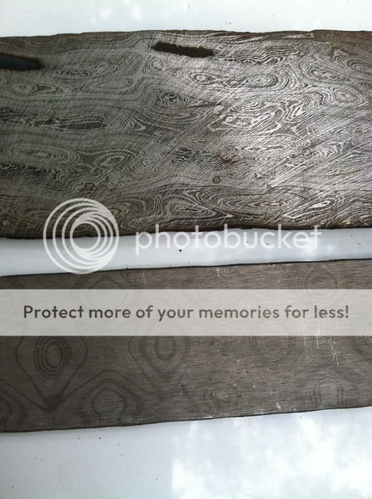

Good day All.
Scored some Damascus steel blanks at this year's Blade Show. What a wonderfully overwhelming event again.
Went on a spree to help some economies and purchased quite a bit of materials and supply goods.
I bought two small-ish Damascus slabs, roughly 1.5 inches by 8 inches, from two separate sellers. When I got home I went to looking at all the goodies and realized that I don't have a clue as to the composition of the metals used in those blanks.
Any way to identify them, or is there a way to get them heat treated without that info and have the final products as go0d as possible.
Feel kind of lame not getting the info or remembering where/who I purchased from, but, I had such a good time.
Thanks in advance.

Should be easy to identify whether one contains stainless by etching in ferric chloride.
Ferric chloride is for carbon steel and muriatic acid is for stainless. Be carful with muriatic acid its nasty stuff.
Thanks for that. I have used Muriatic acid for masonry clean up and it is nasty.
So, FC won't etch stainless and Muriatic won't etch carbon ?
I just want clarity so I can use either or both for identifying purpose.
Ferric chloride will etch both carbon & stainless damascus. A simple way to test if it is stainless is cold gun bluing like Birchwood Casey, the cold gun blue will color carbon but will not color stainless.

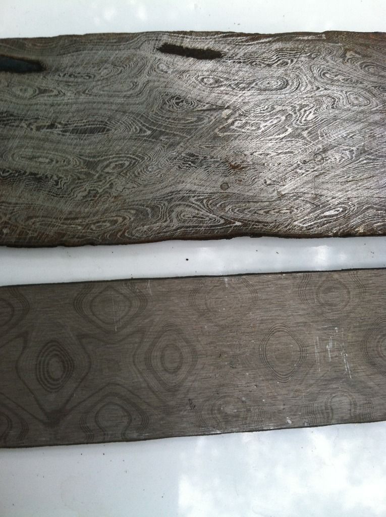

Hopefully this picture shows well enough.
http://i1262.photobucket.com/albums/ii602/SS369369/IMG_4267_zpskylhp4dw.jpg
The top one is Alabama damascus (wave pattern), heat treat info available on there site. The bottom one I am not sure, Markus Balbach makes a pattern similar but it does not look quite the same.

I just have a feeling that it is stainless for some reason, or piece of memory..
After numerous emails to likely suppliers I've not had any good luck.
Anyone have a solution to getting this piece identified well enough to heat treat?
