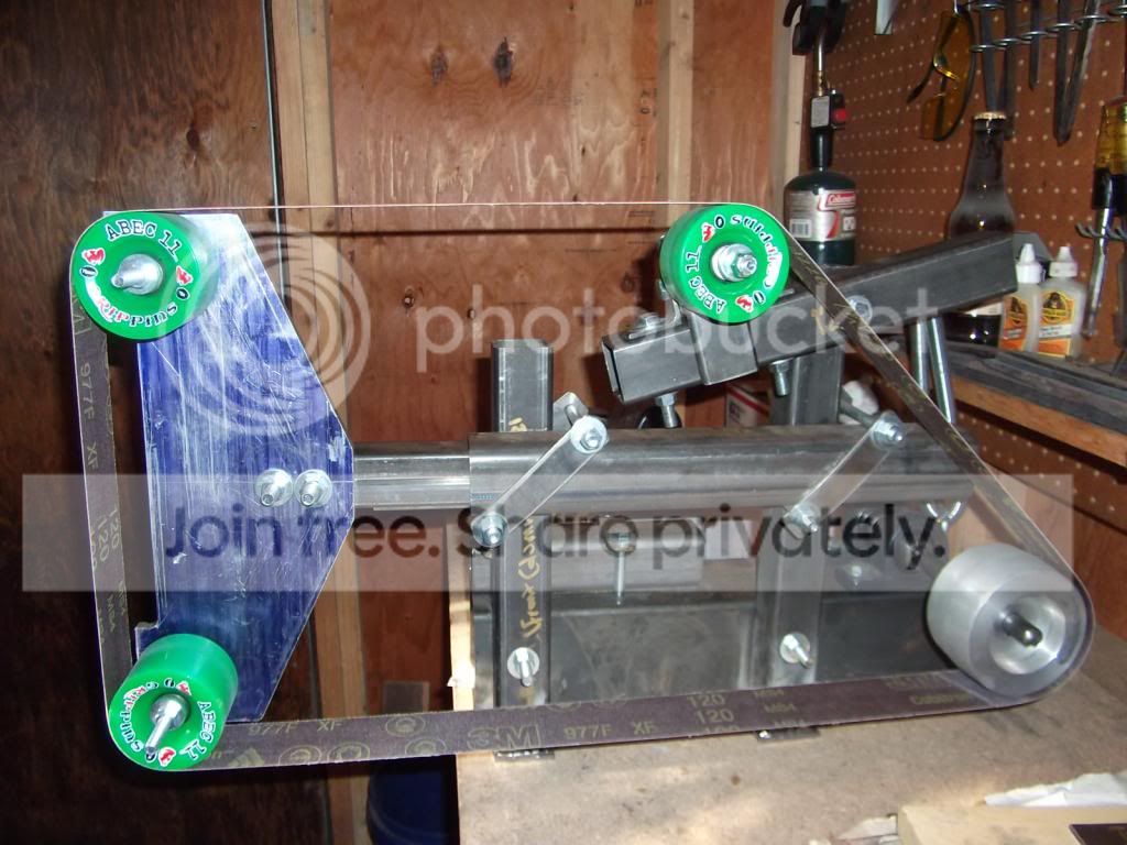

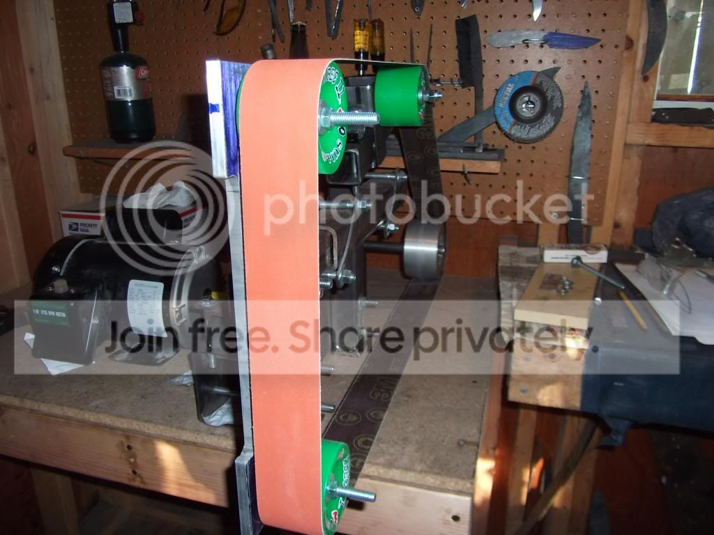

Hi ThirdEgde, I am just about finished with my NWG belt grinder and I did a lot of searching for cheap idlers for a loong time until I came across a thread on british blades that was called "Bashups Grinder Build" (if you google bashups grinder you'll find links to it). Although the thread no longer has any of the pictures anymore I still read through it and found that he had used "Abec 11 Grippins" long board wheels for his grinder.
So not too long ago I decided to email him and ask him hw they worked since the thread was posted years ago, and he replied saying that they works great! I told him I just wanted to get my grinder up and running then sometime in the future I'd upgrade to normal idlers, and he told me that there's no reason to upgrade because they work so well and also make very good contact wheels.

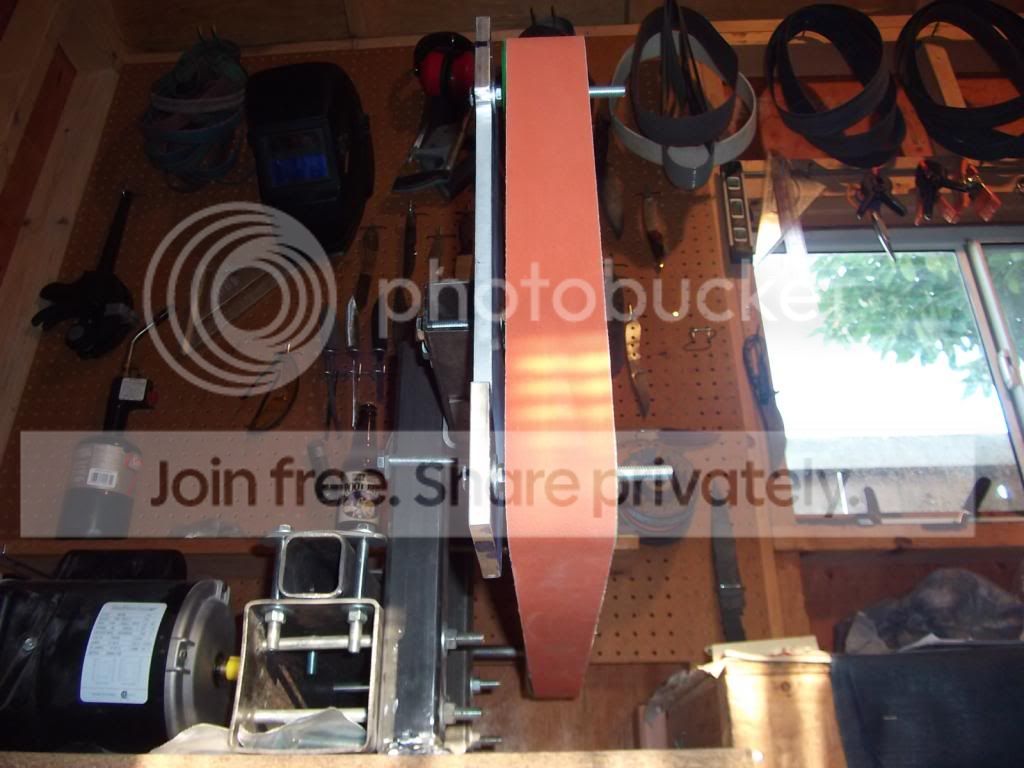

So anyway I ordered a set of 4 off of ebay for like $40 and they also came with bearings and have just now attatched them to my NWG. I don't have the motor wired yet but I have been spinning the belt by hand and they are tracking great and look and feel like they belong there :cool:

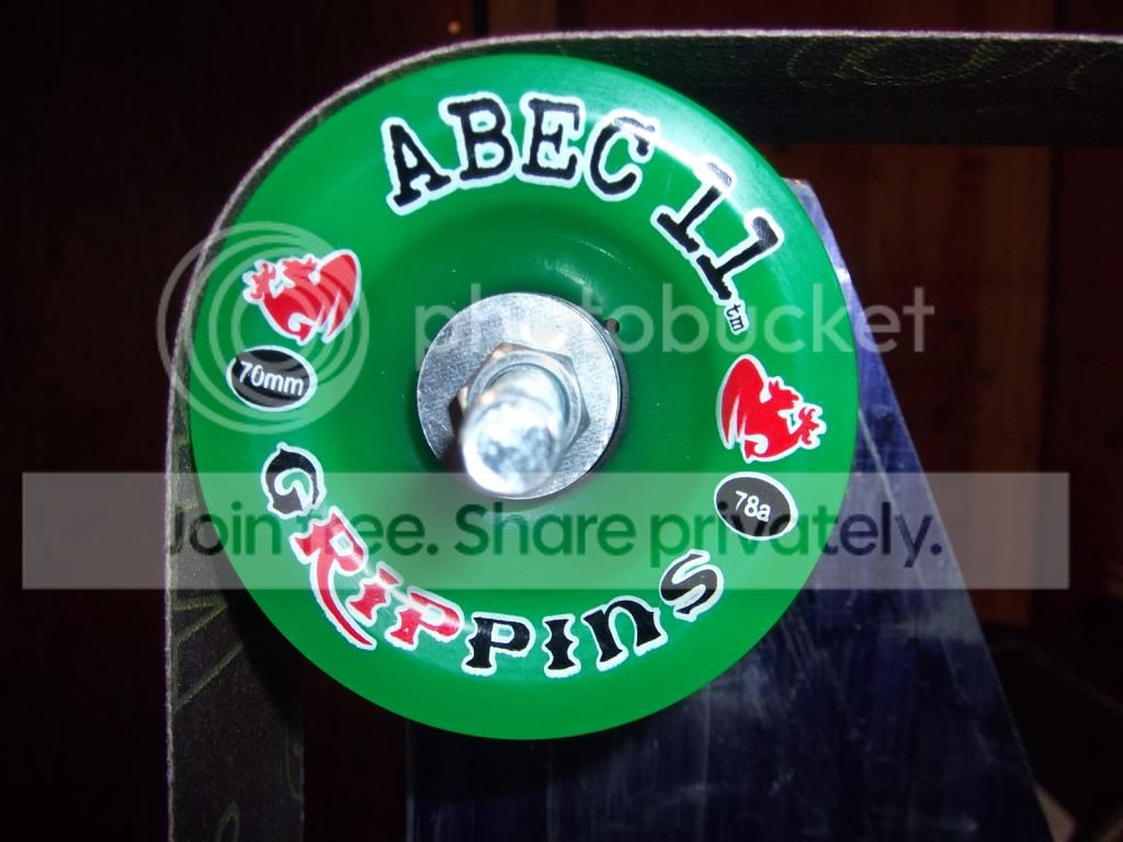

Also, longboard wheels are made from polyurathane which is what they make "normal idlers from as well that tons of people use, and they had different durometers from you to choose from, mine are 78a and are 70mm in diameter and pretty much exactly 2" wide. Another good thing is that these wheels and bearings are meant to go fast and work under rough and heavy loads, so they are ground nice and precisely and spin very smoothly. That's my 2 cents ;)
Here are some pictures I just took on the wheels and my grinder that might help ya out.
Hope this helps :) -Paul

Can you read the part number on the bearing ?
I'm curious what the bearing dimensions are, inch or metric

Hey, I dont think the bearings have the dimensions on them, I do know that they are the same as all standard skateboard and longboard wheels (which use the same size bearings) and also that the inside diameter is 5/16" (which are the size bolts that I used and that are on skateboard trucks (axles). They do have bearings that are better than others such as, abec 7's abec 9's etc, the higher the number, the better the quality. Don't get the word "abec" confused with the name of the longboard wheels I used (Abec 11 grippins) cause that just happens to be a certain brand name of a wheel manufacturer. They sell some other wheels like Abec 11 Gumballs for example etc etc. But abec is a rating system for skateboard & longboard wheels. Hope that this helps and isn't too confusing :) -Paul

Hi Tim :) I don't know of any roller blade wheels that are wide enough to use for a belt grinder. However, before I bought my Abec 11 Grippins longboard wheels I bought another brand of longboard wheels called "Tierney Rides" wheels. I bought those because I saw that they were used on alot of the pheer grinders (which was the only grinder I could find after scouring the net that used longboard wheels for idlers).. When I got them they were horribly off balance and wobbled like crazy, I actually contacted (I forget his name) the guy from pheer grinders via youtube and told him that I bought the same wheels he had been using and asked if he somehow balanced them with a lathe etc. He told me that If i used a belt sander and put the wheel on the belt at a 45 degree angle while on an axle etc. that they would be ground flat. I tried that and a bunch of other ways to try to flatten them but never succeeded. So after a lot more research for cheaper idlers I ended up finding "Bashups" thread on british blades and emailed him about his experience with them which was great and settled for the Abec 11 Grippins he had used which are very, very smooth rolling and flat.
Here is a link showing the Q's I asked pheer on youtube and the answer he gave. btw, in that specific video, the wheels on his grinder are the Tierner Rides ones that I tried, so you can see if they are the same ones that you had a bad experience with on your grinder :) http://www.youtube.com/watch?v=GRc90OhyEKc my username is Lsubslimed and his reply to my questions is the comment at the very top. Thanks -Paul
