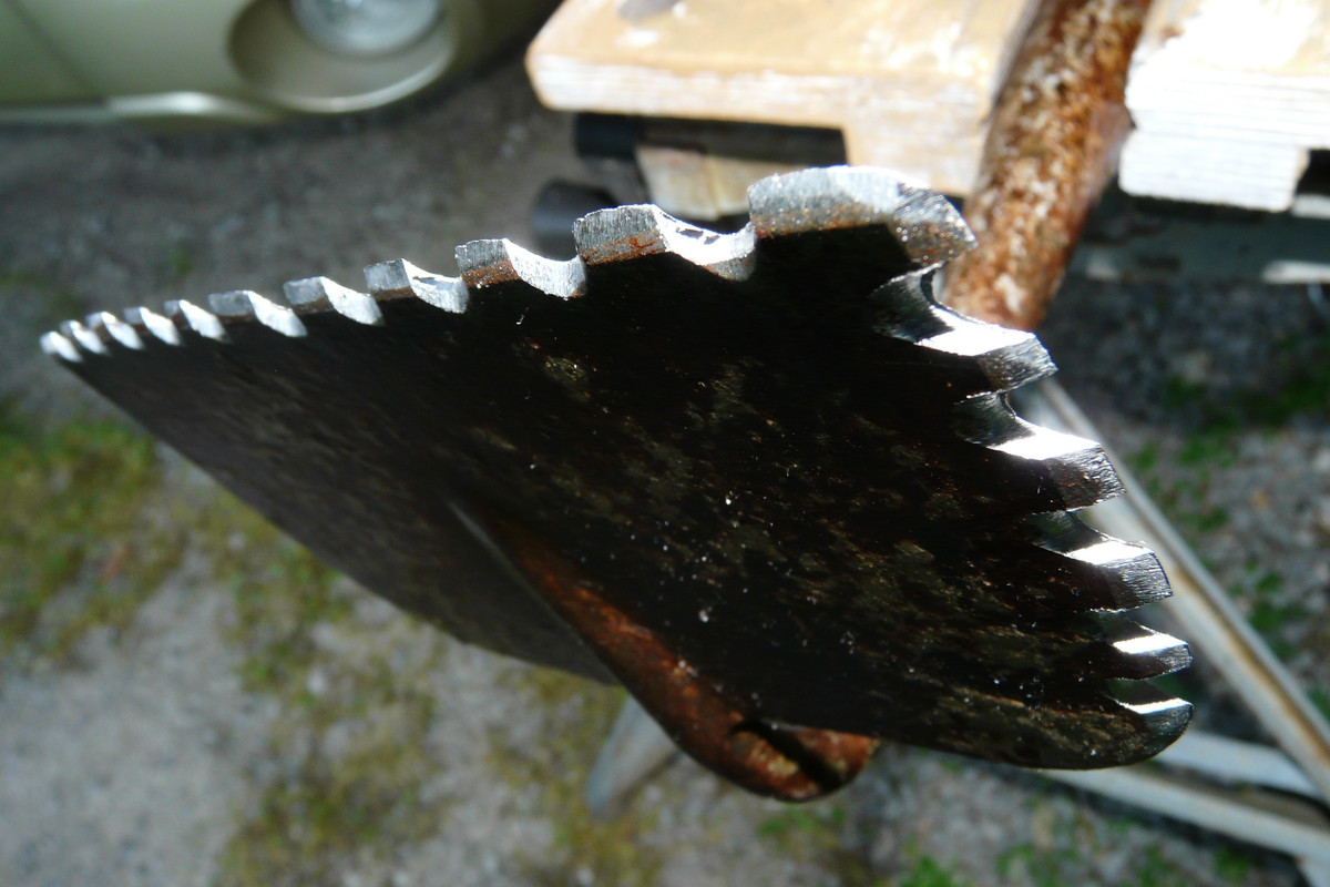

Back on topic, the blade shape looks like it complements the serrations well. That thing’s really gonna bite into rope.
