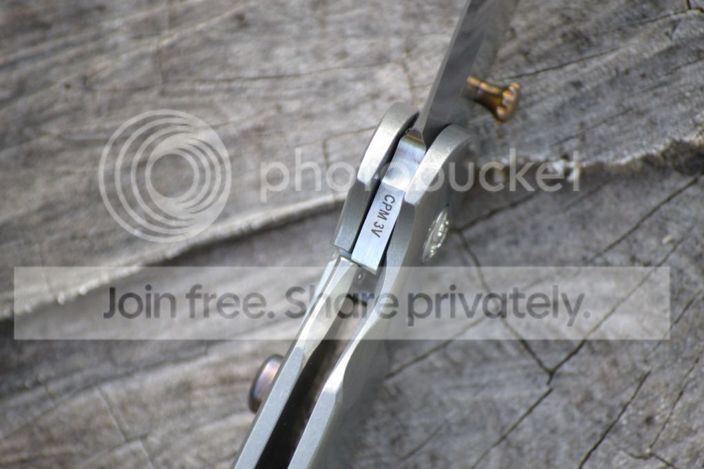

what would you guys feel is the ideal hardness for 3V in a folder vs 3V in a large camp knife?
In a camp knife at 58 Rc it is about as tough as L6. In a folding knife at 62 Rc it would be about as tough as A2 at 58Rc, which is very tough for a folder, I would think, but not sure how high in Rc 3V can go. there is a drastic change in toughness on paper between the Rc points
I haven't sent a knife out at less than 60 in 4 years regardless of type.
In a camp knife at 58 Rc it is about as tough as L6. In a folding knife at 62 Rc it would be about as tough as A2 at 58Rc, which is very tough for a folder...
That will certainly work. I'm pretty sure you'd be just fine at 60Rc or probably even 62Rc in a big chopper, though. As you say, that compares favorably to much softer A2, and A2 is no slouch in the toughness department. Next time I send a batch of 3V out I'm gonna have a big blade run at 62 and beat the snot out of it. :)
i have run 3v at the higher end but on a chopper not yet at 62 (i think it should be just fine tho )
mine was 61 and i beat the hell out of it
I'm a sucker for 3V (ever since i won a Horton Necker). The thinnest stock i've got in my stash would be a Big Chris Bolo, my standard issue for jungle bum; at 4mm thick, my first thought wasn't convincing as i'm used to thicker spring steel BUT don't let it fool you.
I tend to want to cheat the geometry and balance a bit by getting thin stock with a bigger belly. That way you have a light blade with sheer penetration on medium of chop/cut ,albeit HT and grinding are vital. I'm currently testing the stock without any handle and it went through a rock solid, dried branch i had trouble with other chopper and it got me a good minute thinking.....with a big smile on my face.
I always try to run my 3V at 59-60 Rc, right in it's "sweet spot". I have never used it any harder, but have heard some negative results from higher heat treats. One fella I have talked to had a 3V folder that was tested to 62 Rc and he said he actually had much worse edge retention than 3V I heat treated at 60 Rc. Not real sure what that is all about, but I am anxious to hear some results from others at higher Rc's.
