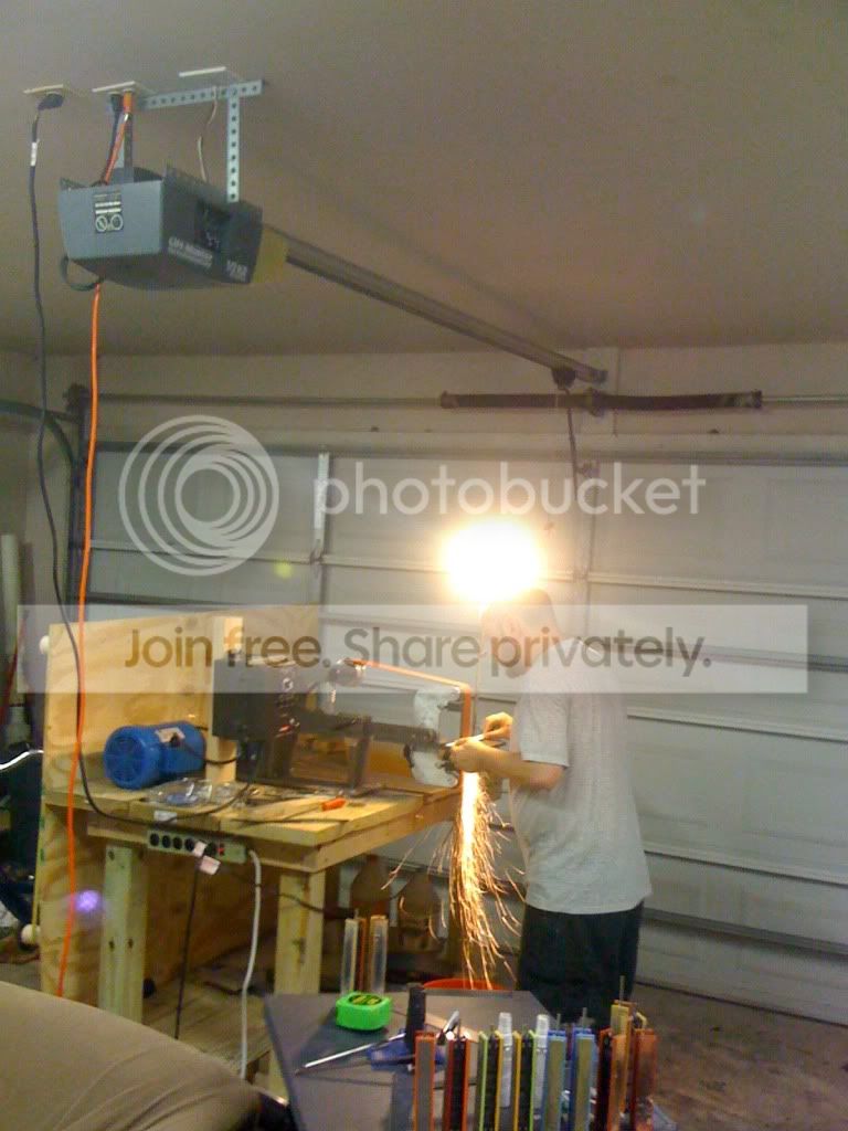

My advice to anyone is even before you have all your equipment stop and think of the layout. Designate a clean area (with a nice desk that will be used like a desk) for leather work, assembling small parts etc and the as far away as possible have your dirty area for grinding drilling milling etc. Dust collection would def be high on my list. I have the whole 2 car garage as my shop and setup my grinder table and other "dirty" machines close to the door and also have them on rollable work tables so if I need I can roll them outside and blow/clean them off outside. Also makes it alot easier to sweep out the "shop" when nothing is in the way.
In this pic you get the idea. Yes I was stupid not wearing a mask. This was about a year ago. But notice the 220v plug in the ceiling (very convient for my layout). I now have my mill about where the couch is in the pic. Easy to roll the grinder table out and clean up some.
Also I wish I would have planed more room for bench grinders/buffers. Id like to have a grinder and 2 buffers on their own table. In the near future I will be buying/building a set of bookshelf style cabinets with doors to keep buffing wheels and other things like small grinder wheels clean and safe from all the dust that gets in the air. I'm still trying to come up with a plan for air filtration which may end up being something in the attic above. Not sure yet.
