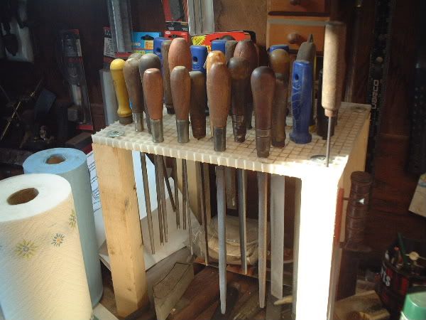

Here's a rack I made for free.
Found the fluorescent light diffuser in a dumpster.
Cut out the webs to accommodate the file's size.
No "banging" into each other as they can not slide.
Been sitting in that same spot for four years.

My file holder is about like that. I milled slots in a 1"x6" for the top and left enough room so the files can't touch. I need to make another to keep the files I use on brass in. Right now they are in plastic sleeves to protect them in a tool box drawer.
