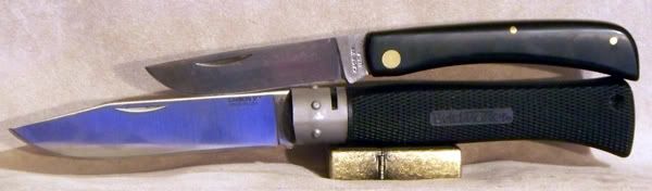

If you like the design you can avoid some of the shortcomings of the wood by hunting down a Cold Steel Twistmaster. It is a more modern version if the Opinel. I reaaly like mine for a camp knife tho it is a bit large...that is a full sized Sodbuster posing with it...
Thanks, I was hoping someone made one with a synthetic handle! :D What size opinel would you say it's comparable to? And what type of steel?
*Hmm, carbon-v steel, but $60 at the only place I can find. Kinda defeats the purpose of a cheap knife...
