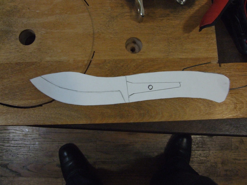

If I have kept accurate count, this is my 14th knife project.
I thought it would be simple. I had the "perfect" profile on paper, but when I transferred it to steel -- wow! There was a lot of subtlety I had never imagined. Once I got the basic profile cut in, I spent better than an hour making little changes all around it, shaving a little here, a little there, with files. I guess it would go faster with a grinder, or a sanding drum.
I did not intend the handle to be that skinny, but I just couldn't resist taking off more and more material; Force of habit, I guess.

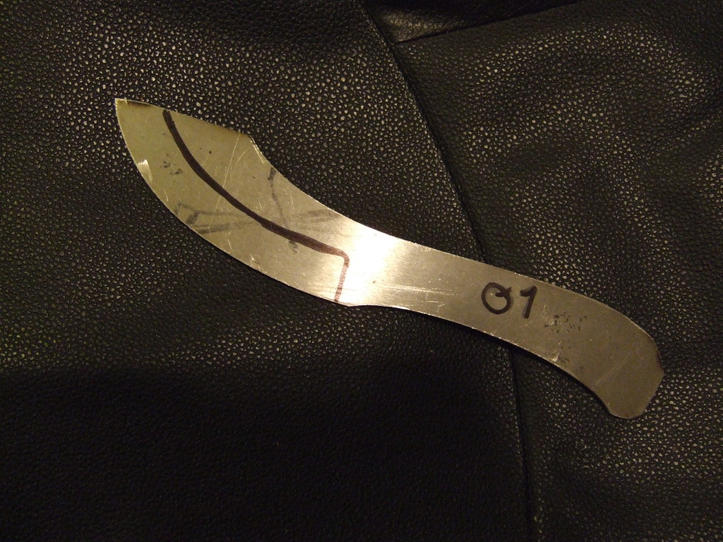

Material: O1
Thickness: .093"
OAL: 8 7/8"
Cutting edge: about 4 1/4"
What do y'all think?

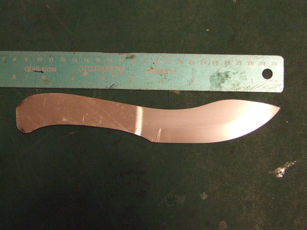

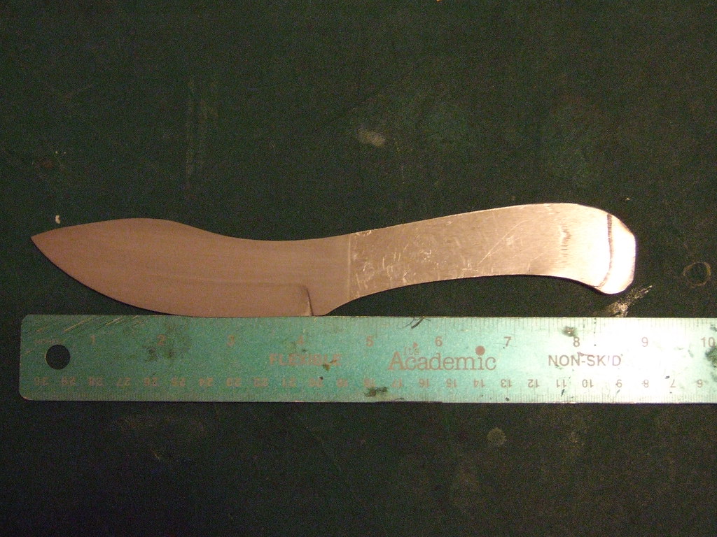

Here is where it's at right now. Sanded to 400 grit.
I cut off that "peak" on the spine, and rounded it off, because I thought it was looking like a cimetar.
It is hard to read the ruler, in these pictures, but the cutting edge is just a tad more than 4".

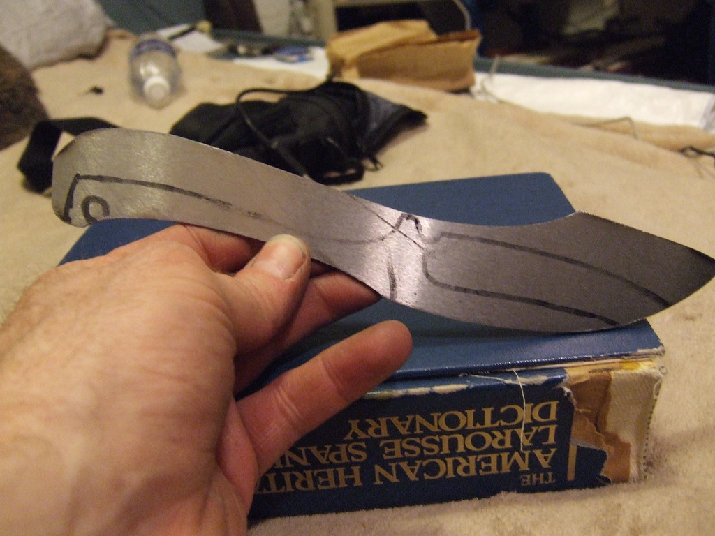

Hmmm. I think the handle arches up way too high. I am pretty sure I can correct that by making this into a stick tang knife.

To bring the handle down, I want to do something like:
