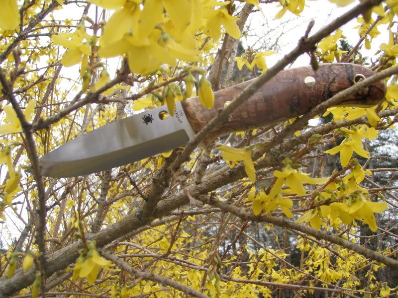

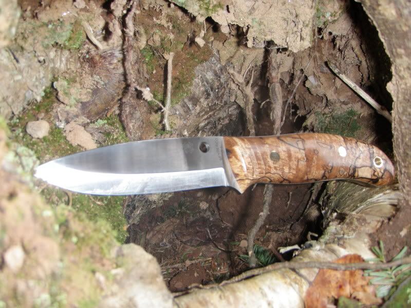

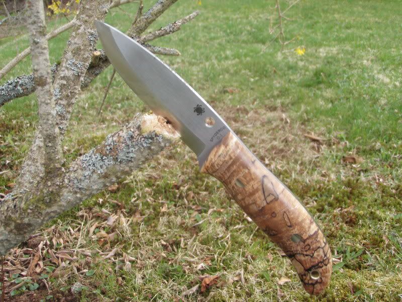

A few shots of my replacement.
Thanx for the kind words. We try.
Great pics Savage, thanx.
I decided that the major problem was the skeleton hole at the hilt. This reduced the amount of material capable of absornbing the hit. We'll be removing the first hole on the next run.
Thanx for the opportunity to "improve the breed".
