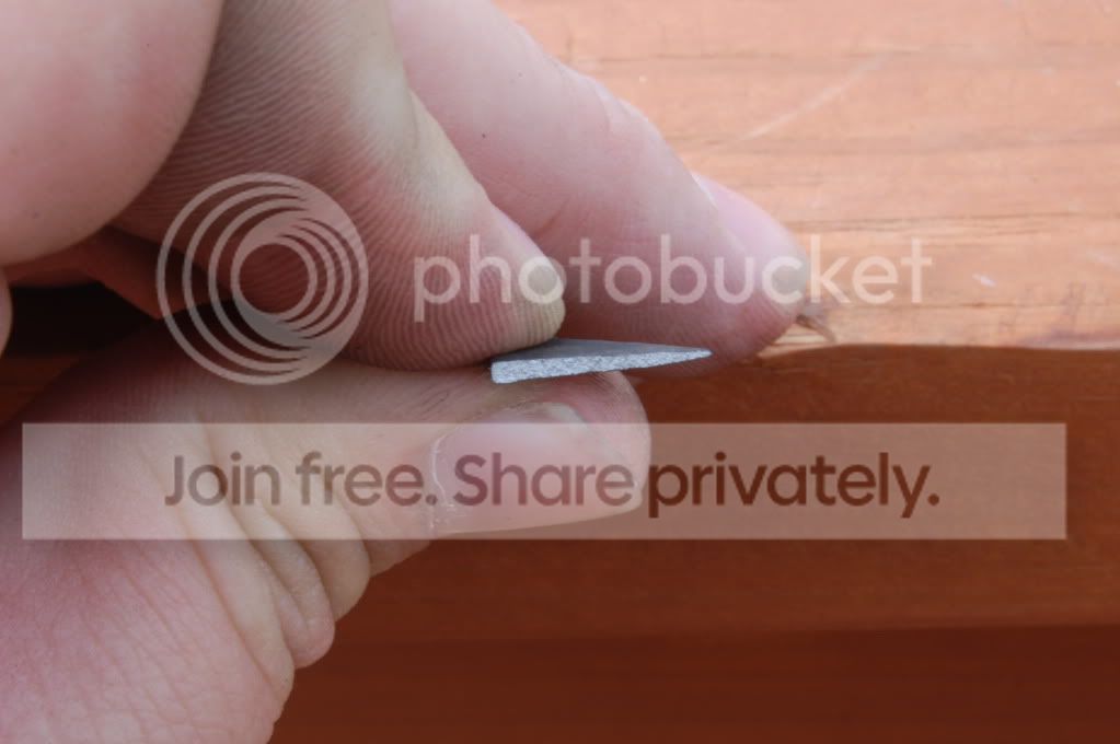

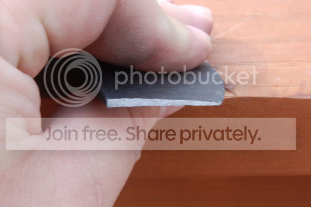

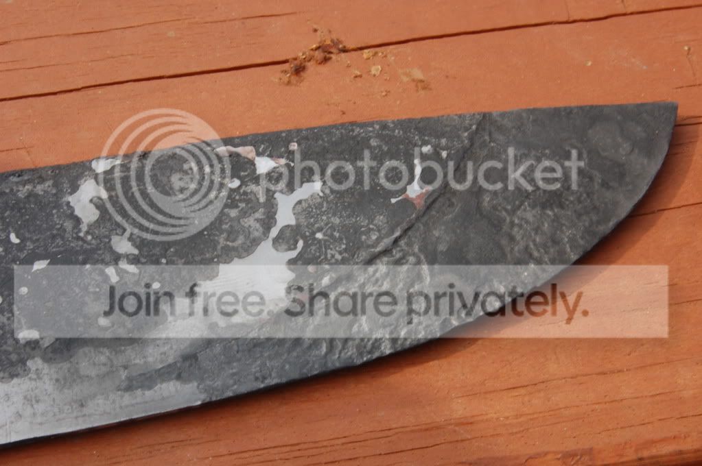

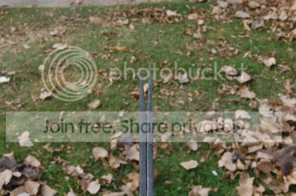

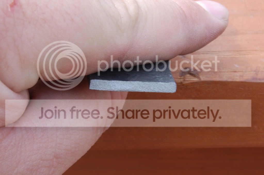

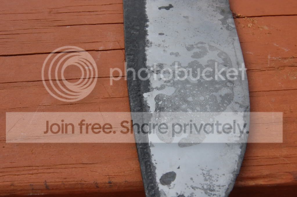

OK, here are some pics.
You can see where the blade is eaten away, and the grain size is MUCH larger than I'm used to.
Obviously the whole thing wasn't eaten up, so it didn't all get too hot. That to me screams radiative (infrared) heating. I wish I had a pic of my oven. The thermocouple is in the floor in a trench. I had it covered with a piece of firebrick, and it is ceramic sheathed, so it is by and large proteced from radiative heating. The blades, not so much. Like I said, not a problem when everything reaches equilibrium, but a huge problem on heatup. My chamber is about 11" long, 3" wide, and 4" deep. It has 120" of Kanthal coil in it, operating on 240VAC. I get from room temp to 1500° indicated in 8 min, with a piece of firebrick covering the thermocouple.
