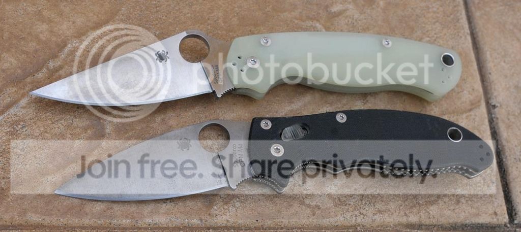

The rust in that photo came right off with a little metal polish I had previously bought at the auto parts store.
I have a PM2 with M4 steel that I use in my EDC rotation. I cut apples and so forth with it at lunch then wipe it off with a damp cloth before putting it back in my pocket. Maybe some very light hints of patina so far. (This photo was taken a few weeks after the photo above.)
Ya, that looks awesome after a little metal polish. thanks for the pics.
