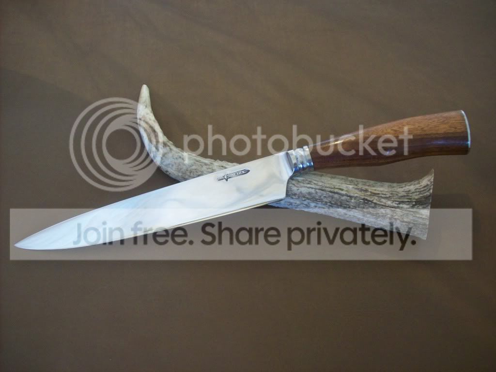

The pictured blade certainly looks like it is alternating layers of steel, copper, and brass. It's interesting that there don't appear to be any steel-steel welds in it: each layer is alternating steel/non-ferrous. Could they just be "forge brazed" kind of like making mokumegane?
One thing where a forged blade has a plus apposed to stock removal (imho) is a blade forged out of round stock
Like Markman makes them, or gaucho knives
Those knives are cool. If you don't mind me asking, how do you forge weld by yourself without a power hammer? Really big hammer? A ton of pounding to get it to weld? I haven't done it yet so I'm curious.
3Lbs hammer and a lot of time. That's it
