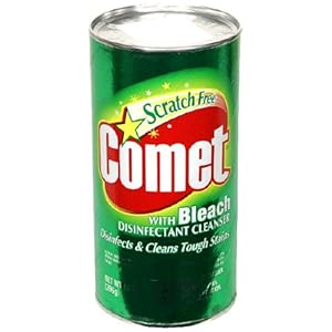

from what I see
Get some abrasive cleaner like ajax, comet or other types. Your sharpmaker is very clogged and wont perform well like it is now
get a towel sprinkle some on the towel, wet it and scrub the sharpening rod against the cloth until its white, rinse and repeat.
Get some white compound and strop it. Shaving but not cutting paper, and only shaving on one side is definitely a burr.
thanks for all the help..i have my ceramic rods in the dishwasher now..it actually says in the manual they are dishwasher safe.....I will try some of ur tips this evening and post the results

As far as cleaning those rods, there is no way a dishwasher is going to do the job of removing the imbedded particulate. You need to use the comet or bar keepers friend and elbow grease. While I don't use the SM any longer, the hardware store I worked at had one and we used it daily. If a knife was super dull, we would rotate the rods to where the apex of the triangle made contact against the blade. While this does reduce the surface area making contact, it increases the pressure on a given area. Once a new bevel was cut, we would then rotate them to the usual position and use the flats. Then on to the white rods.
