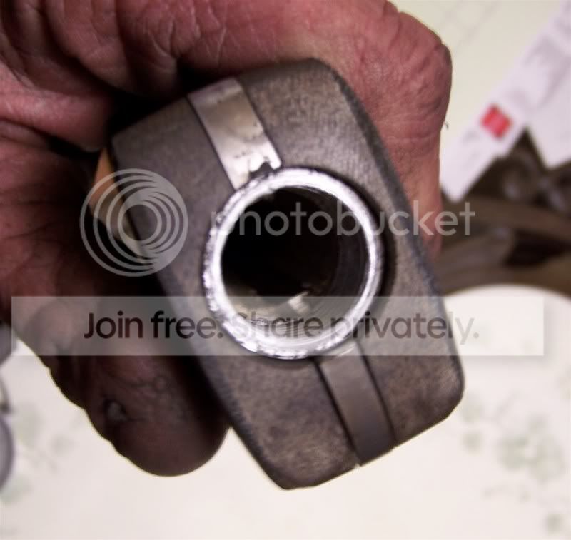

i had a guy make me a custom wsk type knife , he might be worth a shot , here is a few pics of mine. mine also has a hollowed handle for survival type stuff. if you want his name pm me.
