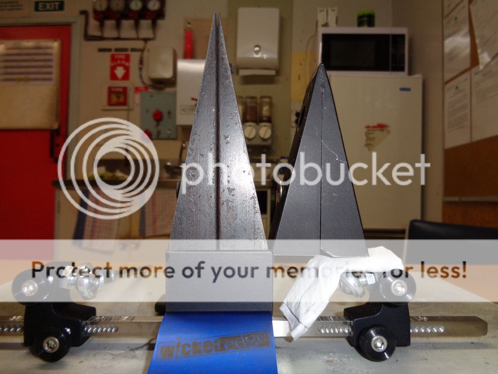

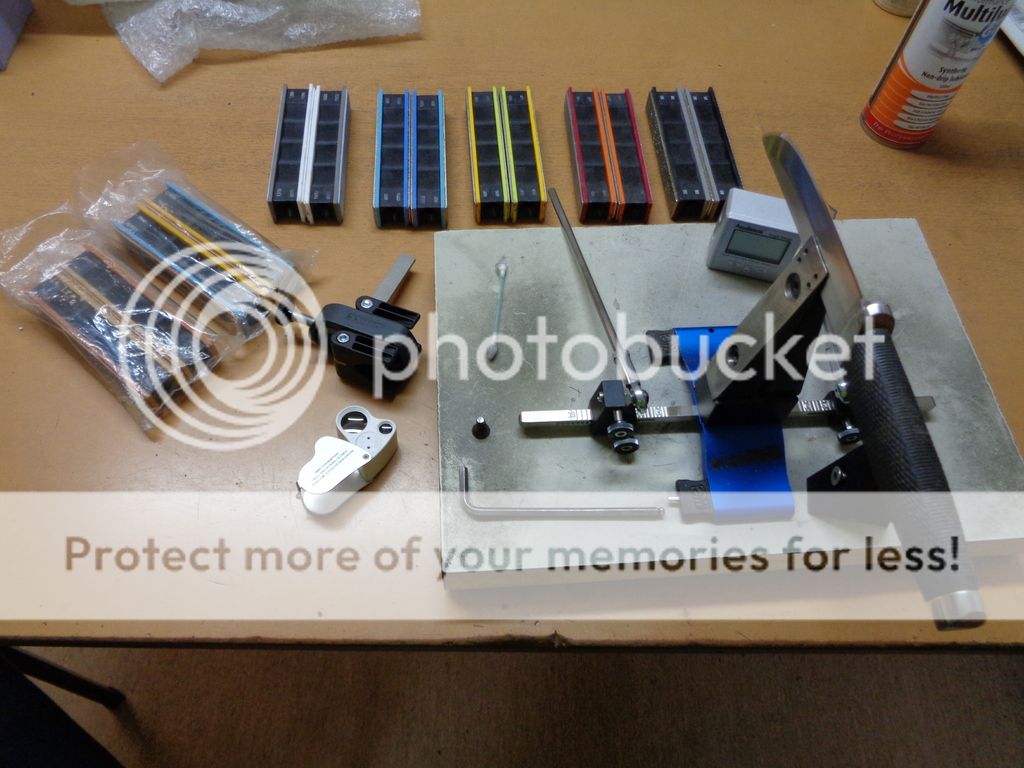

Congrats! It took a bit to wear in the stones on mine, I suggest finding a few old blades to practice on and break in the stones.
I got the upgrade kit a while back, also had a fitter make up a steel clamp 'bout an inch higher than standard. Together with the riser block and Tormek clamp I can get very acute edge angles. Needed to get longer arms as well (from oldawan).
The angle cube is well worth having too.
And the 50/80 grit stones are awesome for re-profiling/removing a lot of steel.
Only real problem I've had is bending the clamp by overdoing the tightening with shallow FFG blades too high in the clamp.

Bought sharpener and angle cube
