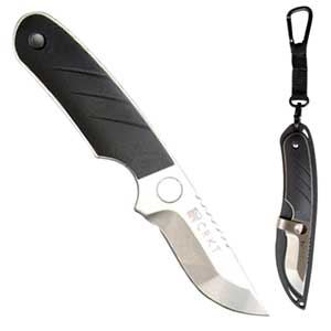

A knife, if you need to add one here. I'd propably loose my PSK pouch before my neck knife, so I don't have one in my PSK. But, to a pouch that size, find a flat and light little knife. A folder might be a good idea, as long as you know the limitations. For example, a CRKT Side Hawg might fit.
