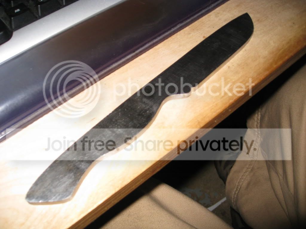

Well, I gave up on the "no power tools" rule after about 20 minutes of trying to file of the teeth of my file. And since then it has been going very smoothly. Much more smoothly in fact than I ever thought it would.
Here's what I'm up to.
Now I've run into my first problem. Setting the bevel.
- Will a single bevel grind work on such a thick (3/16 inch or 5mm) blade?
- If so, how do I sharpen it at a consistent 22 degree angle?
- How do I keep the angle when going up the belly to the tip?
- If a single bevel won't work, what should I do differently?
