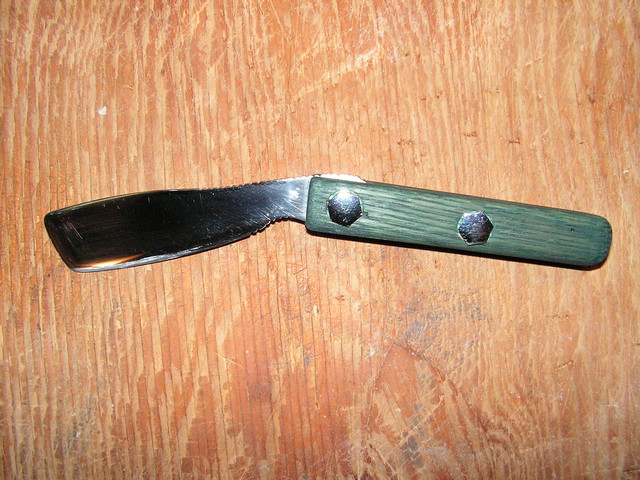

I wanted to say hi to everyone and introduce myself. My name is Kevin,I am new to knife making.I live in Stockton Ca . I am almost done with my first knife .I came to the forum in search of other knife makers in the area and info .
a>
I hope the pic works, it is my first so far.
Was...was that a wrench? Sorry, but the weird drop to the blade looks like this Pedro bike wrench I keep on my pegboard for working on my dremel stand.
I think I fixed the pic thing.Yes ED that was a 13mm pedros cone wrench (I'm a bike mechanic)it holds an edge pretty well.the bolts in the handle are seat pin bolts (just stuff laying around the shop.I am working on # 2 I'll load pix when I am done.
Hey Kevin, good to see you got on here! Now we just got to get you some better tools! Give me a call and we can get you a list of basics.
