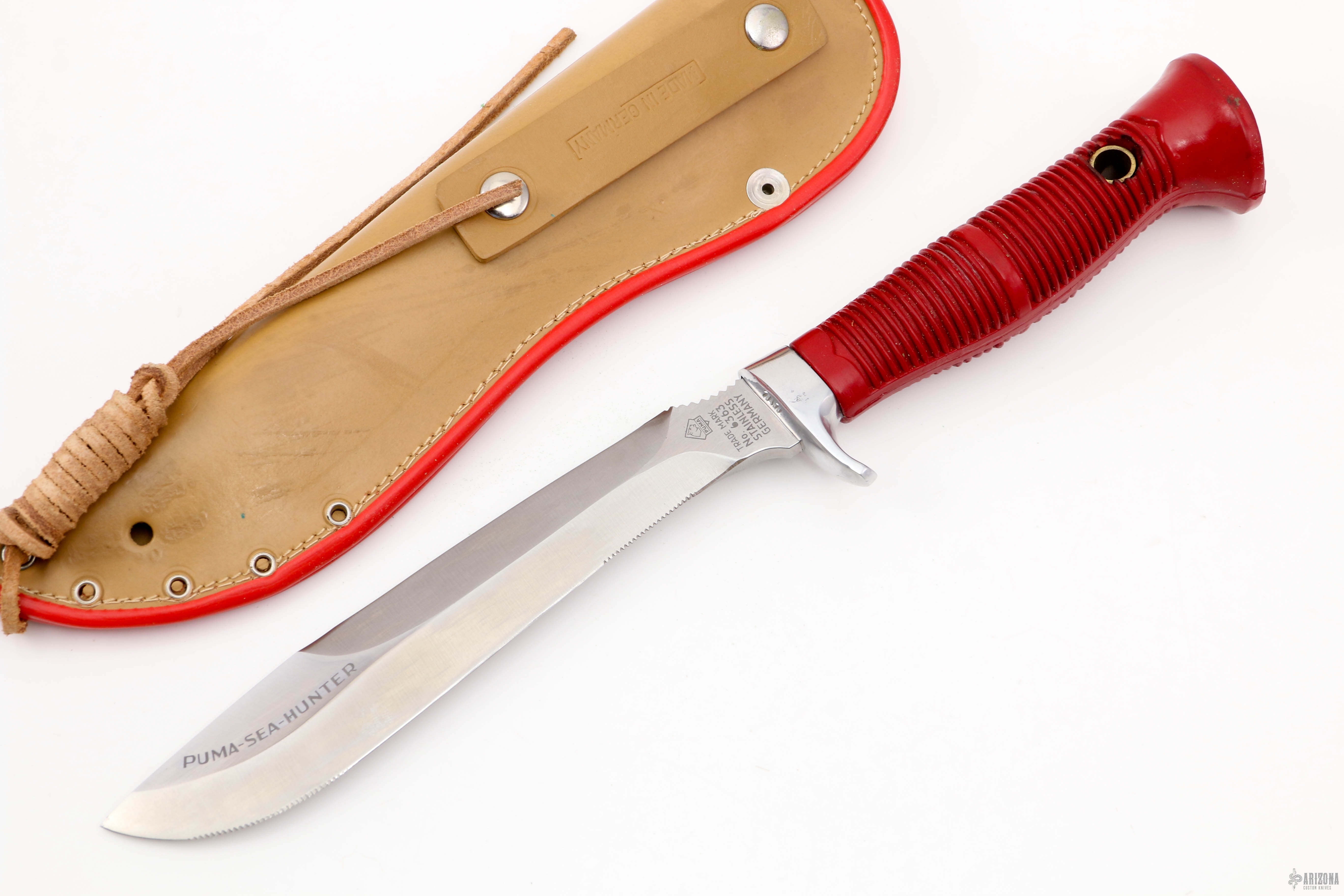

My Puma Sea Hunter that I got in 1975 while working at Abercrombie & Fitch is stainless, but it's a "dive knife".
Grabbed this image from Google, as I didn't have time to look for my own pic at the moment.
