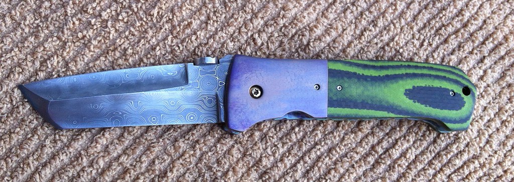

I free hand grind as well. A Fred Rowe bubble jig probably would have helped greatly with my tanto grinds but I'm pretty comfortable free handing those tips in now
I'm sort of glad Fred posted, as his jig is the type I was talking about.
A bubble jig does not restrict you, it enhances you. You still make the grind, the jig helps you keep the angle more consistent.
Fred sent me one of his jigs a long time ago. I used it and thought it was, OK, but still continued to do 99% of my grinding by eye. However, there are places where it really helps me.....like clips and specific angle tasks.
I have a customer who is obsessively determined that his fancy knife has an EXACT 17 degree edge. He evidently has asked several people to do it, and they all have had various reasons they can't/wouldn't do it. I will just stick Fred's jig on the blade, and make a perfect 17 degree edge.......no variance. I have other ways that I could make a rigid jig, and maybe get the same result....but it would be far easier to let my hand control the jig, than the jig control my hand.........and that is what I like about Fred's jig.
I agree Stacy (and with others) that a jig can be useful in a specific task or situation but for general grinding I wanted to be free from having to make a jig for each blade shape or make a jig that would fit all blade applications. Not only that but it saves me time because I do not have to worry about putting the knife on or off a jig and having to switch sides on the knife not to mention (my jig anyway) it is a pain to have to dunk a heavy steel jig and knife into water to cool it while grinding. Not using a jig will also allow me to make different adjustments on the knife while grinding. Thats what I liked about Fred's Bubble Jig; it will allow me to use (and develop) free-handed skills while allowing me to keep grind lines equal and not have a cumbersom jig to deal with in dunking in water and moving around the grinder. And by design should allow me to keep plunge lines straight. I'm not trying to "plug" any one product I just wanted to give an insight for those like me who are beginners in knife making and who are of the mindset that they have to compensate their confidence with a jig. If you need a jig I would not be against using one, I just don't want to use one as a cruthch if I don't have to. Thanks again for everyone's input and opinions on the subject. I value everyone's advice especially since you guys have way more experience than me. Thats the beauty of different opinions, if one way does not work for a certain person there are other adaptation (or a combination) to try.
