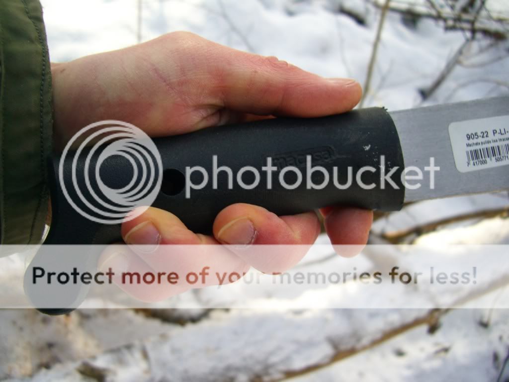

The Colima has one of Imacasa's famous polypropylene handles, which is injection molded directly to the tang. It's well formed and incredibly comfortable, as well as being just about bombproof.
The stickers that came free with the machete. :D I usually like leaving them on until they wear off on their own. I guess I'm just lazy like that.

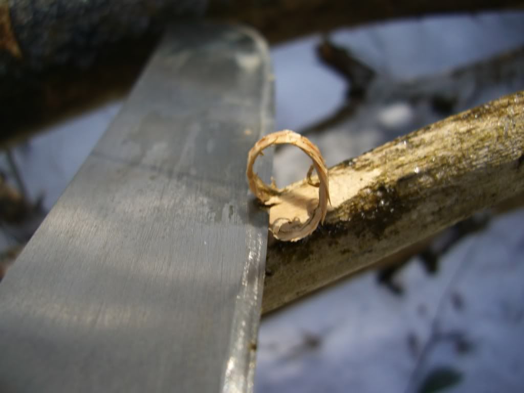

Chopping time! I was, again, very impressed by how well such a light machete could chop. Don't expect to get far if you don't use a good pinch grip with it, though. I found a slightly more exaggerated rolling snap had to be used to get strong results. Again, this is just the nature of the do-all camp knife/small machete balance that this piece does so well.
And a curl thrown in for good measure. Please note that the way the curl is breaking up is because this is old spongy wood. It would look like a conventional fuzz stick curl if I had had something that wasn't decayed or alive around, but where I was seemed only to have those two options. :o
